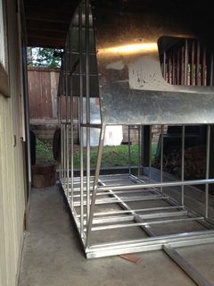

I probably should have joined back in May.. anyhow I am well into an all aluminum TTT build, well everything but the half-axles, RV door, windows, sikka-seal, and some mounting hardware which is mostly zinc plated. Essentially the whole trailer and frame is MIG welded 2"/.125 and 1"/.125 6061 square tube aluminum, skinned in 16 gauge/0.051" 5052 aluminum with all 3/16" aluminum-aluminum rivets, sort-of like a jon boat.
I have the rest of the month to push through on:
-mounting the RV Door (full sized RV, paid cash bc it was shipped with minor scratch on it) and 3 crank-out windows (purchased from Li'l Bear site when it was still running)
-flooring.. I really want to use aluminum honeycomb but am having trouble finding a Canadian supplier (or otherwise for that matter)
-sourcing custom stainless steel u-bolts.. no luck so far in Canada, found one boat trailer supplier in California though
-mounting the rear hatch/cargo door.. hurricane hinge, or just a beefy aluminum 'round tube in square tube' style
So first off just wanted to say hi to everyone.. I'm not even looking at the budget on this prototype, there will be time to do the master BOL in the fall. I'm just very obsessive about not hitting any 'deal breaker' obstacles.
Lastly, I am in Vancouver, BC and perhaps there might be some folks who are local (Washington, Oregon, Alberta, etc.) that would want to consult with me.. I've never done a project with so many 'firsts' in it, but so far it is pushing through, waay behind schedule (if there is any).
I put a teaser picture in just so everyone knows I'm serious about this build even though I am a new poster.

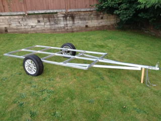

Not to be critical but to critique, I hope you are planing to add additional strength to your tongue arrangement. As it is, the single tongue tube welded at the first cross member, won't last a day with a load on it. Also, why half axles? Again, consider the stress on the aluminum tubing where the axle mounts. And will the half axles have brakes?

alaska teardrop wrote:I hope you are planing to add additional strength to your tongue arrangement. As it is, the single tongue tube welded at the first cross member, won't last a day with a load on it. Also, why half axles? Again, consider the stress on the aluminum tubing where the axle mounts. And will the half axles have brakes?
Alaska Teardrop, first off, just want to say Hello! I will definitely check out the link, I am a data junkie. Ok, on to your questions.. so first-off, to clarify, the single tongue tube runs the entire length of the trailer.. better design structurally but I think what you are talking about is something like, this perhaps:
Edit: removed oversized photo with 584 views, added proper sized photo
the real stripped down version of the concept
Secondly, half axles allow the trailer to be lowered more, whilst leaving nothing in the way for clearance issues. Thats essentially why I chose them.. well that and the weight savings as they are 14lbs apiece (the rims and rubber weigh 62lbs). They are Flexiride, adjustable splines, rated at 930lbs, and the way they are u-bolted to the frame (Edit:: this says 3 temporary generic steel u-bolts a side, soon to be zinc plated, galva, or stainless steel, it will be only 2 u-bolts needed a side and they will probably be flat u-bolts made of zinc plated steel) and with a welded plate, at both the frame edge and cross-beam, I think they will be ok. Having said that, 80 miles on a logging road will test them pretty fast, I'm sure we can both agree on that. Trust you me, I deliberated on this point for many an hour, but decided to go with the half axles. Consider me a tester of them, we'll see how they do.
Lastly, no brakes on the half axles, I am confident this trailer will be so light it won't need them. Part of me wants to throw out a target insulated, ready to rock bare bones weight - lets say 600lbs. I see no need for brakes at this weight (swaybar included). Around 800lbs or so its getting in need of that weight addition.
I really appreciate your input, sir. Not afraid of being critiqued at all, that's why I joined this forum. I've reached the point where I need constructive criticism. You see, the thing 'aint done yet, so I can build others expertise into this piece of functional art.

Thank you Mark. Glad to see that you'll be adding those two extra tubes to the tongue. The full length center tube is a good idea, however, welding it at the most critical point where the tongue meets the first cross member sets up the potential of stress cracking. A single tongue is especially vulnerable to fatigue because there is not only vertical stress but also horizontal stress that is not really a concern with double or triple tongues. Here is a post by Andrew that explains aluminum fatigue: viewtopic.php?f=35&t=65130&p=1157563&hilit=aluminum+fatigue#p1157563
And another about tongue strength: viewtopic.php?f=26&t=66458&start=45 (13th post down)

Thanks again for the links, Fred! Being that this trailer was to go really light, some long term structural integrity loss will likely be the case, boy do I ever love your post about the frame for the Northern Lite - you put the two angled tongues all the way back to the axle! In my concept I had done the same, actually ran them all the way to the the back of the trailer. I really like all the re-inforcements that frame has around the axle too - looks super beefy. Now that frame looks confident to take logging roads!
Just to clarify, you were saying that even though the main tongue is a single long piece of square tube that even welding the 'cross beams' at all the vertices (the first, front most being what you are describing), creates an area for fatigue? Also just wanted to mention that the two angled tongue beams will be welded and bolted to the frame and main tongue in the 5 spots that they contact.
Also any comments on half-axles and your experience with them? And surge brakes? - which do sound like a fantastic idea.. perhaps after the build is functional. And also if my post sounded a bit cocky/ego, please do not take it that way.. I must admit yesterday was the first time I towed the combo, just a run through the city, but geez, Fred, it seemed to tow really well even though the tongue weight was low (guessing <10%) since its still a work in progress. I was so happy last night because having taking it for a spin with no apparent problems, I just felt I had finally made a major goal in my build.
