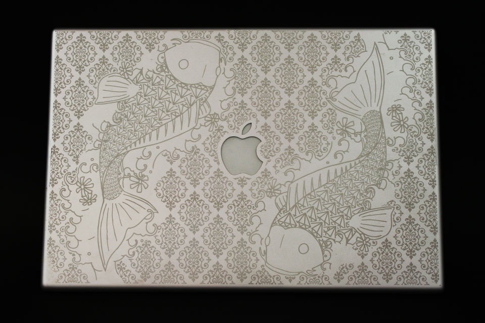

I know it has been a few weeks, here are some pics I took from the models been working on in the shop.
Since the laser I have access to is not high enough power for etching metal, I etched the acrylic to get a rough Idea of how I would like to go about "tattoing" the aluminum skin before wrapping. Also been busy with a lantern design I am working on for limited edition release... and a website... and business classes... been real busy! :D
I have already etched glass with laser, so I know I can do some pretty fancy custom teardrop windows that will look fantastic playing with the sun and moonbeams. In the winter of 2016 I hope to be accepted for a 4 month artist/design high tech residency in SF and that will allow me to produce the FireBeetle at a high degree of finish... meanwhile will continue on the mule prototype at TechShop.

It was suggested to me to possibly try acid etching the designs onto the aluminum skin by using vinyl lettering masking as a mask. Anybody here have experience with acid etching aluminum? What chemicals to use? Thanks! :NC

We used to use muriatic acid to make copper clad printed circuit boards. We also etched labeling into aluminum project boxes using the same thing. Muriatic acid is a less pure form of hydrochloric acid. Both very dangerous if handled improperly. Fumes very bad too.

BUT, I did come across some stuff called ceramark and Theramark for laser etching into aluminum and steel. Looks real promising! Now need to find a co2 laser in the Bay Area big enough to due a 5x10 sheet of aluminum. Will do some smaller scale experiments in the next month or so on the shop lasers as a proof of concept. :twisted:
