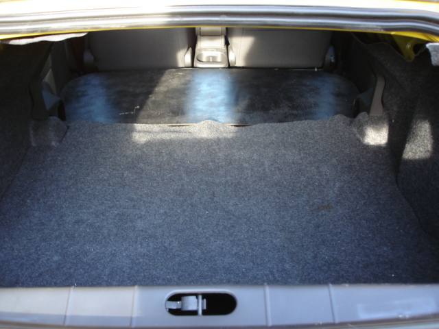

If I must cut creature comforts, such as smaller holding tanks, batteries, etc. then so be it. I have already removed the rear seats from my tow vehicle to free up more interior space and completed some other weight saving mods.
This might free up a couple hundred lbs. from the trailer as I relocate some goodies to the car, such as the generator. I could also increase the size of my car battery and mount the inverter in the car, so I could go without this 90lb+ wt. in the trailer.
