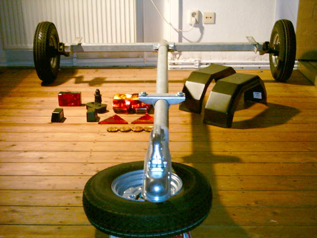

Next news: The delivery man ringed, but i was at the TÜV. So he dumped an axle and a tongue at my door. The first thing i thougt was: Wheels and mounting parts are stolen, because the stickers on the two packages spoke of three packages. The callcenter told me, that the missing package is a phantom booking in the system and not yet brought in by the supplier. Lets see...
I'll post pics when the frame- parts are complete.

Hi,
Mike, the T&TTT is a very special experience for me. It was the longest time of lurking in a forum ever, without posting or getting bored.
parts are here :)
weights are:
axle 50lbs
tongue 22lbs
clampings 6lbs
2 wheels 17lbs
lighting, fenders 7lbs
together 102lbs (46kg), the rest up to 660lbs (300kg) is for the tear body and bed and ...comfort.

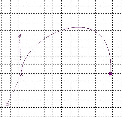

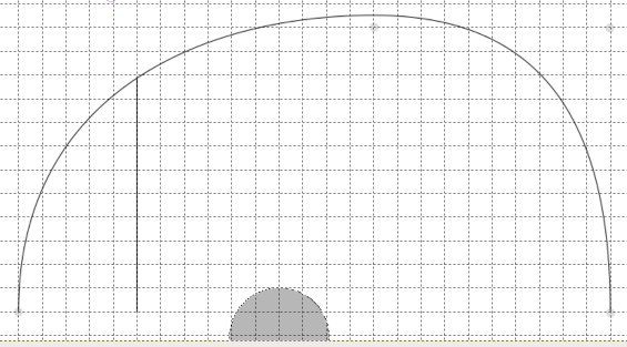

I played with curves. Gimp is an application like photoshop, part of my Linux distribution UBUNTU. You can lay a grid, and draft traces with a wonderful auto curve funktion. Disadvantage is, that i found no way to save the resulting pic together with the grid, so i used the screenshot funktion. (EDIT if you save as a jpg it seems to work including the grid.)
Just set a point by holded leftclick, move the mouse still holding leftclick and you get a position marker and the pointers. Do the same at another position to get a trace. Modify the trace by playing with the pointers.
This layout is made with 3 positions, two at the ends and one at the highest point. The grid is 10cm (sorry, i think metric ;) ), three squares aproximate one foot. It is not the final layout, just a result of playing.
i did not find an online calculator giving me foot and inch with one calculation step, for example 6foot, 5inch, any suggestion?

Ah, so you are playing with splines. That's a very powerful way to make really nice curves!
As for the conversion, since you are working in cm, just divide by 2.54 to get inches. then plug the result in here:
http://www.metric-conversions.org/lengt ... o-feet.htm
Your profile for example is 125 cm high or 49" or 4' 1"

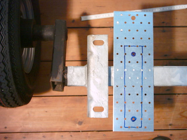

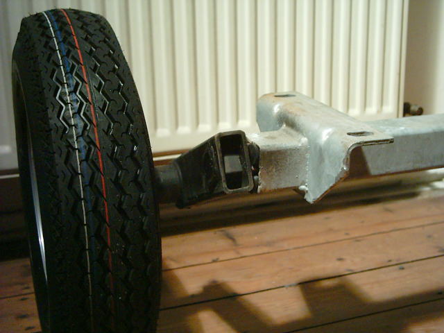

I found this:

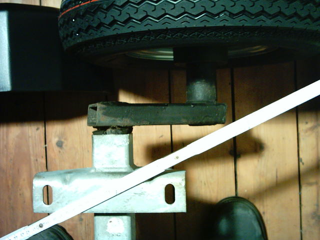

(Note the scrappy apperance of this brand new "made in germany" axle...)
It`s diameter is 0,07 inch (1,9mm), so i have to stack two or three? Elastic but sturdy like a leave spring? Bolting this to the axle without elastic wood inbetween will give a correct bolting, and this number of wood screws screwed in the floor frame will give a sufficient joint? Of course the frame has to cover the whole screwing area.
What do you think?
It would be fine to have an even floor inside, but if it`s not enough for the TÜV i may drill bigger holes, use threaded screws, and use another plate as washer at the top side of the floor. I think it`s overdone... ...and weakening the frame.

I say 'No' to the 'bolting plate' - I think you must bolt through the floor of the trailer and use a big washer under the head of the bolts. Otherwise there is a big risk the axle will be pulled off the trailer, which has happened.
The easiest way to get big washers is to buy a piece of flat bar, say 50x3mm, and cut short lengths of it. Here are some diagrams I did about exactly this question a year or two ago:
Green is side wall, blue is floor, red is floor framing - where the axle mounts a large piece of strong hardwood (such as oak) should be added as floor framing - the framing everywhere else does not need to be so big, so this piece of wood is only needed locally.
Remember: what you are aiming to do is to connect the axle to the side wall (the floor is not important) - the axle is bolted to the (red) floor framing and that is glued to the side wall, so this is a good connection.
Andrew

:oops: :thinking: now... ...the first real problem... ...a chain of problems, leading to this problem.
Thanks a lot for giving your clear thoughts!
Of course i tried to get a really suiting axle/frame for my project. "How many axles of that special built do you want to order" was one of the best answers. Noone has short axle taps in stock to weld to the crankarm. Even the crankarm itsself you see at my axle is a special of this manufacturer, others only have bowed wider cranks. An available axle with slightly better measures would have cost twice as much to reduce the problem by 1 inch, means still far from the sidewall. Heavier too. And with rubber for 1650lbs.
In short: I had to decide if i want a teardrop with overdone big and wide, heavy, and offset rim wheels. Or small wheels at a funny distance to the body -
or to accept complications having the support not under the sidewalls.
Then i found this picture of that floor repair at an european caravan trailer. There is nothing exept the wood floor (1/4, 1.1inch thrifty framing, 1/8 ) between the frame and the walls. You can say the frame is screwed midway to the torsion boxes floor. I was stunned :thinking:
That is what i think: contrary to the widely used teardrop designs the walls of an european trailer are more an insulated visual cover than a wall. They are made of 1/8 dekor ply, a little bit of wood, can't call it frame, and an aluminum foil, loosely glued together. If you would step hard straight on the bare egge of these sidewalls the inside ply would crack, and the outside foil would wrinkle, even with a little wood in the edge. The wall covers are more stiff than any squared timber. I don't mean strength, i mean timber is more flexible than a sheet of ply or aluminum. With an european trailer wall it is neccessary to distribute the forces carefully to the full lenghth of the wall. That is what that flexible wood floor does: distributing the force from the frame carefully and flexible to the whole length of the walls edge. The strength of such a trailer comes from flexibility.
An usual teardrop design consists of and is based on serious ply walls. Even with light framing and 1/4inch ply covers it would be impossible to crack such a wall by stepping straight on the edge.
The superleggera design is the most consistent lightweight tear design i`ve ever seen. The combined V-tongue/frame design with torsion axle is brilliant. But with the V beginning at the clamping piece of my "type approved" straight tongue the angle is bad, and the crankarm collides with the frame. But there is a TÜV-Rule... if the tonge is an integral part of the frame, then no type approval is neccessary. But in a book about trailers, published by the TÜV itsself, there is the explicit warning that not approved "part of frame - tongues" are subject of discussion with TÜV engineers. :x
...type approved V-tongues ARE available, looking just like the superleggera frame, but heavy, and rated to 2900lbs.
Next is, that the hight of the fenders above the small wheels gives a pleasant sitting height to tie the shoes and to have a first look at the rising sun. So i planned to have a shelf holding the fender, the backlights, and to sit in the door above the wheel. The door partly above the wheel has to do with the necessaryly light galley and hitch weight... there is not much wall above the axle...
So i ended up with that perforated piece of sheet steel... and i want believe, that it is possible to connect the given axle to the body with plates and suitable wood framing in the floor. Bigger plates? Same plates, but bolting trough the wood? Bigger and bolting through? Other idea?

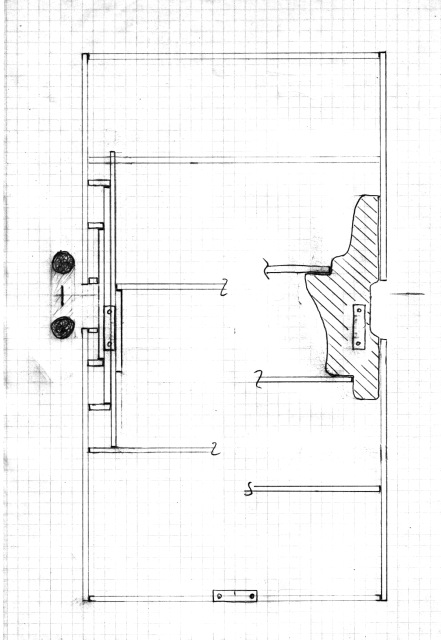

I'll sketch up a wooden floor framework next

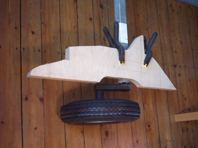

it's using that plates :thumbsup:
Few more levers and rods, and the springs for the front suspension may be mounted unter the seating area ;)
1*2 timber vs. 1 1/2 Ply (2*3/4):

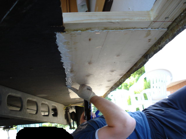

Postby bernd » Mon Jul 14, 2008 4:05 am
Hi,
sawdust at last :D
... 1 1/2 best birch ply
I think to use one of these plates with an additional 1 1/2 washer on top, one plate at the bottom, bolt through, with a washer, additional crinkled spring washer(s) and a nylock nut. The Bolt is M12. Birch ply is hopefully hard enough to keep enough tension. (See the sketch above for further details)
Not ideal, any suggesions for improvements?
Greetings, Bernd
