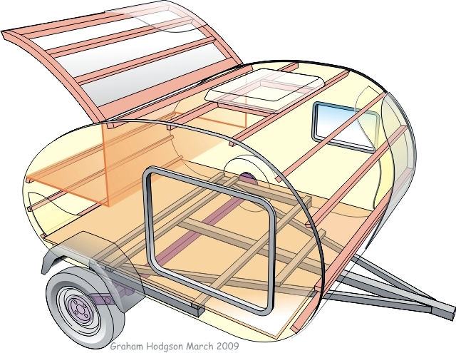

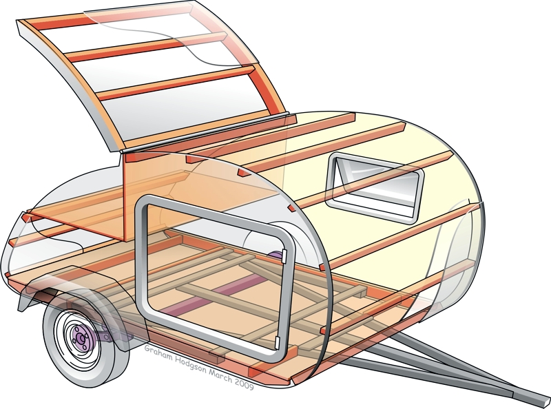

Dutch is no problem! I'm building an ultralight with a very rounded profile. It's my first, so I want to keep it simple, and tow it behind my Reliant.
Mark McD wrote:Okay... I was sidetracked in the garage. :)
4' x 8' x 1/8" luan plywood = 10 lbs , approx
.032 H32 5052 Aluminum - .46 lbs per square foot...
Thanks Mark for the data. I'm actually enjoying this part of the design process, designing down to a specific weight. I've revised the design (again!) and cut down the chassis to save about 7 kg of metal. I've gone back to a more rounded teardrop shape too. I realise this is far less space efficient, and the bed is just long enough for me, but I like the looks.
I'm doing some sums right now to work out what the saving is by making the sides from 15 mm ply cut out like below, and faced with 3 mm ply inside and out (compared to 18 mm solid ply)

Postby Mark McD » Fri Mar 20, 2009 9:54 pm
There you go, Graham, that should shave off some weight. The profile looks more natural ,too. :thumbsup:
Nice CAD work, too!

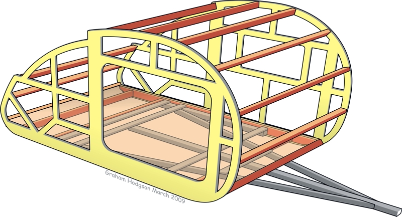

Postby graham17457 » Sun Mar 22, 2009 9:20 pm
The revised design with the trimmed down chassis

Postby Juneaudave » Sun Mar 22, 2009 9:57 pm
The design is looking really nice!!! The curves look just right to me!!! :thumbsup:

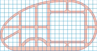

Thanks again for the encouragement. I've trimmed my design down even further, and have been doing some weight calculations.
This is about as small as I can go and still lie down! I've looked at various constructions, and at present the estimated weight for the chassis, floor, walls, kitchen surfaces, cross members, floor supports, hatch, roof and ceiling is 165 kg. That leaves a maximum of 85 kg for the wheels, hitch, axle, mudguards, door, window and lighting. I'm planning a wall construction of 15 mm ply cut to a skeleton (see below) and faced on the outside with aluminium and on the inside with 3 mm hardboard or 3-ply. Compared to a solid 18 mm plywoood wall with aluminium facing, this saves over 12 kg.
I'm planning an aluminium roof (no plywood directly beneath it) and a 3 mm hardboard ceiling. If I can't keep down to 250 kg, then I may look at molding fiberglass sides. I'll keep you posted.

Postby graham17457 » Sun Mar 29, 2009 8:26 pm
mallymal wrote:...By the way, I too am thinking of going for a "cookie cutter" inner wall (12mm? 15mm?) then facing it with ply inside and out (3mm? 6mm?). You could then work insulation into the voids (either rigid foam sheet, or even spray on).
Thanks for the compliment, I still enjoy illustrating. The cookie cutter idea is a good one, and in my calculations, the weight of the two sides came down from 48 kg (solid 18 mm ply with aluminium face) to 36 kg using 15 mm ply and a 3 mm inside face. That's a 25% saving, it's still the same thickness, and with a foam insulation, it may even be cosier inside!

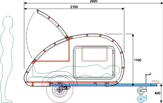

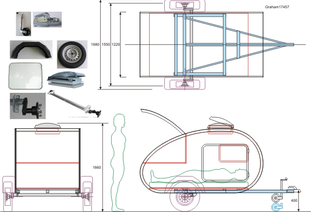

Postby graham17457 » Thu Apr 09, 2009 11:12 am
Further refinement of the design - a sliding hatch instead of hinged. It should save some weight. The panel slides up into the space between the roof and the ceiling. Plastic u-channels as guides. I've also gone to 10-inch wheels instead of 13 inchers for weight saving. My Reliant runs on 10-inchers, so it should look better anyway. Unfortunately the PCD is different (4 inch on the Reliant, 100 mm on the trailer axle), so no common spare!
