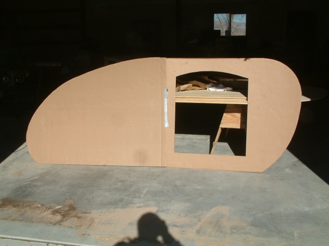

we are half way through our build. It is 5 x 10 woody, room for queen bed. We are using 3/4 ply, not sandwich build but solid, for simplicity even though it is heavier. we used two pieces of birch ply biscuted together (good reason to buy a biscut cutter) as 5 x 10 ply was not available locally, but in your area I would bet you can find it. yes, there is a seam, but it doesn't look bad and it is smooth. Epoxy and fiberglass over top to seal, then marine spar when we finish my first experience with epoxy. ) You do loose a little bit of the "cute" factor with less curve over top, but comfort was more important to us. we downloaded the generic plans and bought Steve's shop manual, and that, along with lots of ideas from this forum is all that has guided us. As for trailer, my husband is a welder so we were lucky enough to just build exactly what we wanted to fit, but most folks don't have that option! More pics in my album, and more to come soon as we are putting in the headliner.

I wish I was as far along as you guys, really looks good. I checked on 5 x 10 plywood here in Houston but no luck, I figure on splicing which from a cost stand point is best. I'm not 100% sure on the exterior yet but leaning to aluminum, so splices don't matter. I also agree with you that comfort is the most important thing, espesically if we go on a week or two trip.
Thanks for sharing your build.
