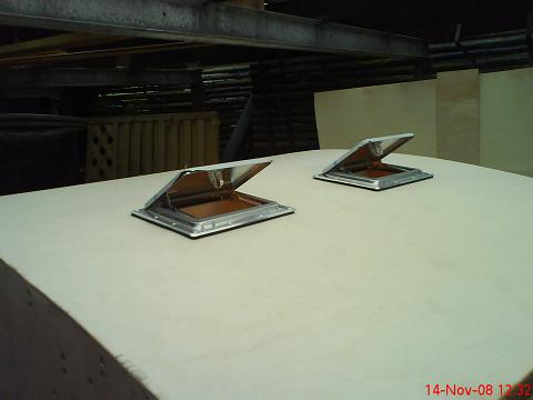

Postby jackdaw » Fri Dec 04, 2009 6:30 pm
Loving the twin roof vents
Are they available from the internet ?
Dave

jackdaw wrote:Loving the twin roof vents
Dave
That is cool isnt it with the twin fans..Im liking it as well. :thumbsup:

Thanks, Dave.
I was in doubt of what to install untill I found these in blanc alu:
http://www.reimo.com/en/36130-roof_air_extraction_flap_with_insulation_ring_260/
I didn't want something large and I found these to fit perfectly with the alu skin :)
I had to buy them via a local dealer since they don't sell to private people in DK.
