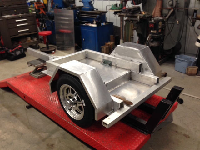

Postby Sarge 51 » Sun Jan 03, 2016 8:59 pm
ok some progress. Fenders are on just waiting for the body sides to come back from the fabricator. I could not bend that long of sheet in my brake sorather then cutting and welding I spent the money to have it done with a press brake
fenders in place
IMG_0389 (1).JPG (104.4 KiB) Viewed 522 times

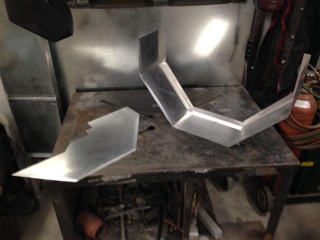

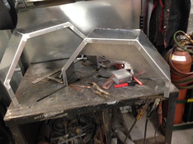

Postby Sarge 51 » Sun Jan 03, 2016 9:02 pm
These are the fenders before install. I made them from .060 instead of 1/8 I was able to bend them on my brake then TIG welded the miters.

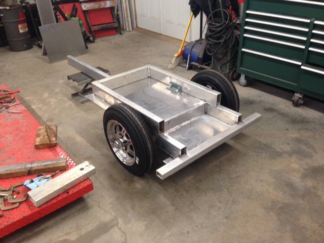

Postby Sarge 51 » Sun Jan 03, 2016 9:05 pm
Last one for now. Hope to have the whole body done by next weekend.
