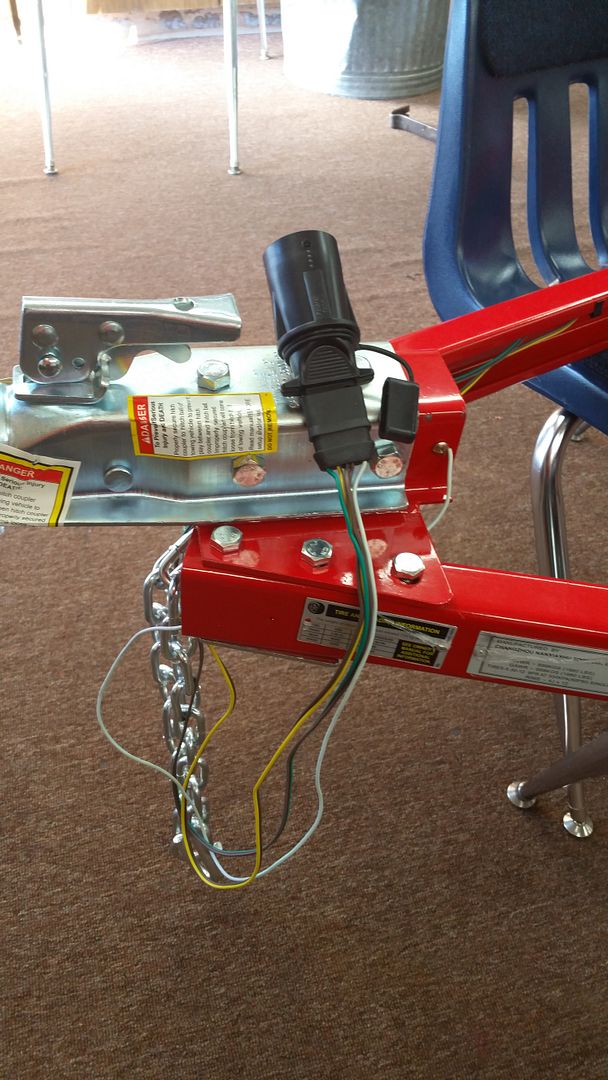

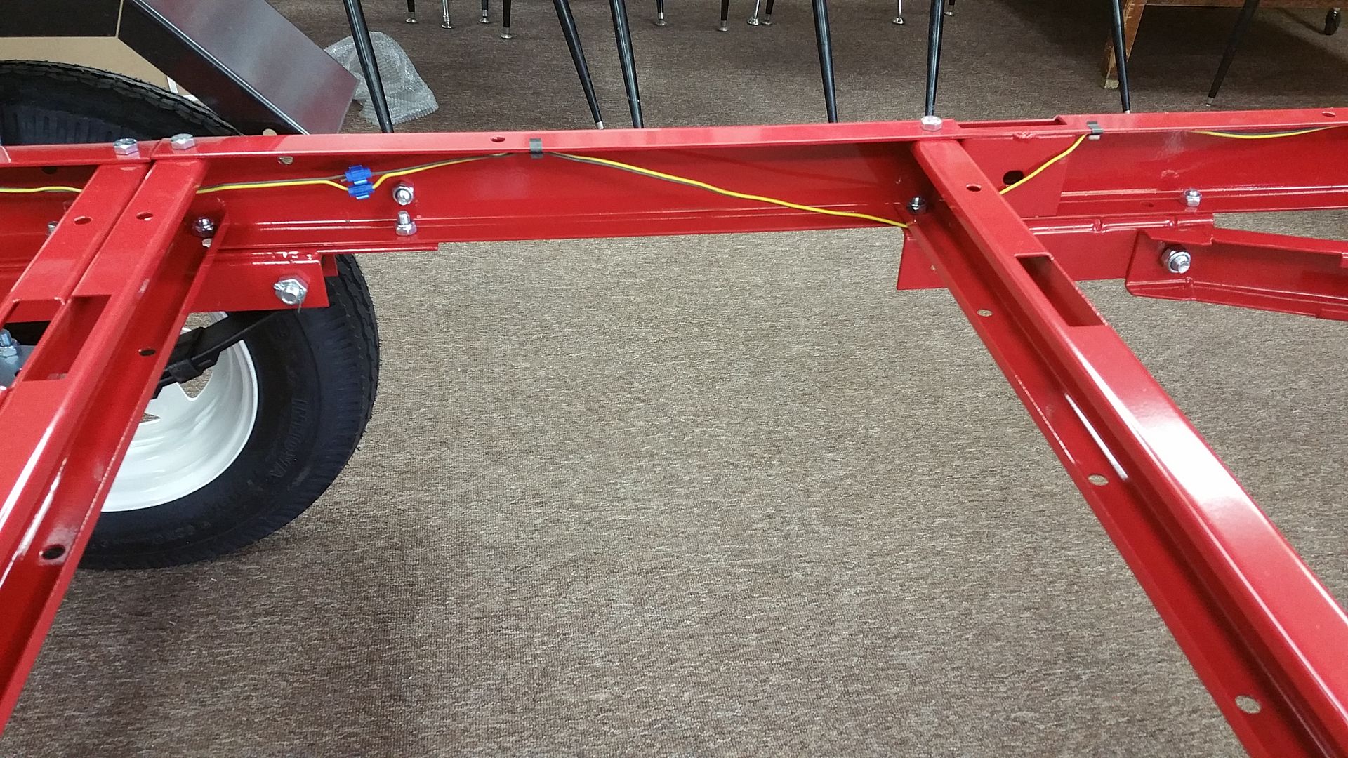

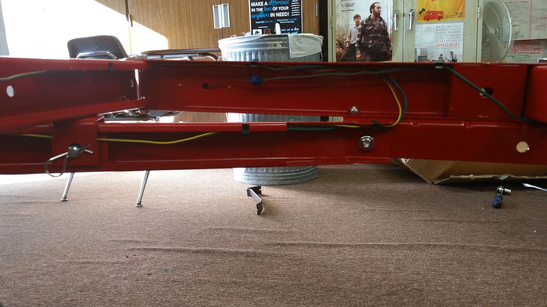

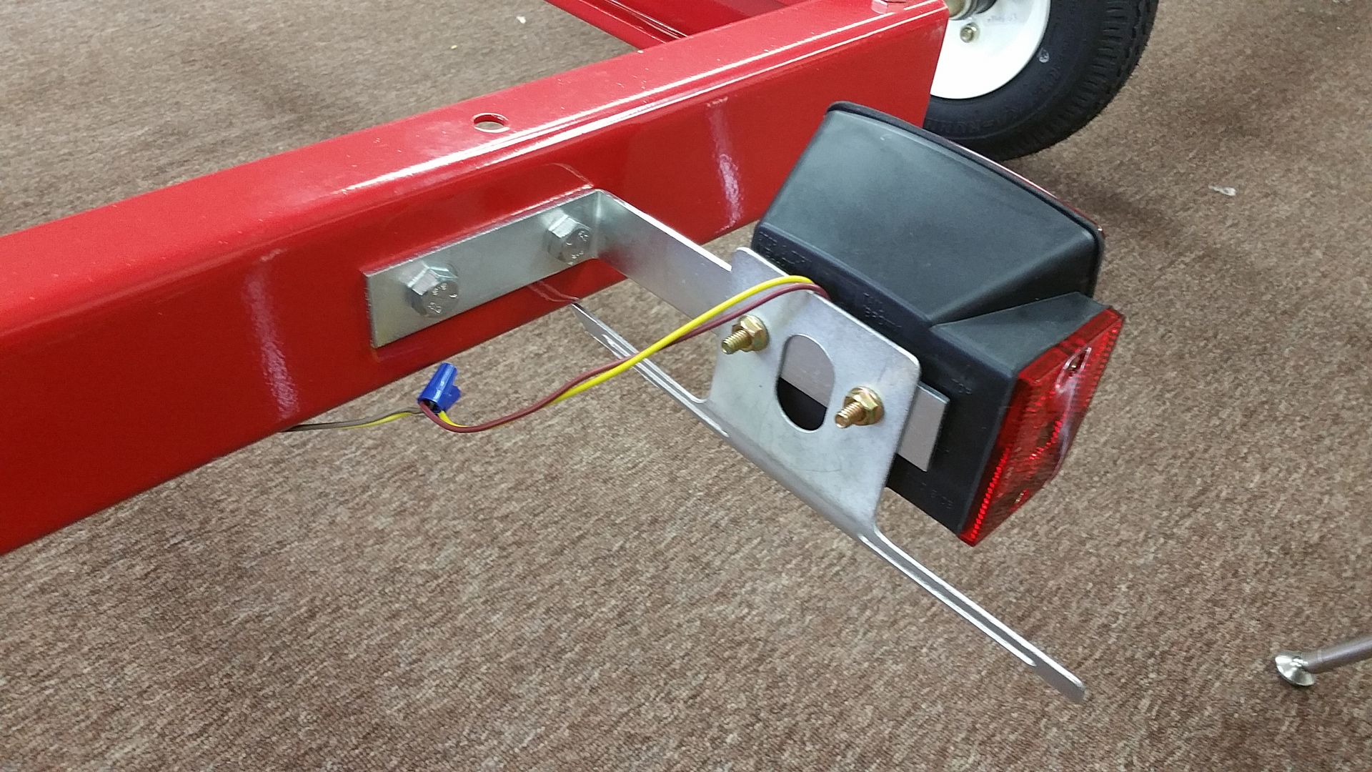

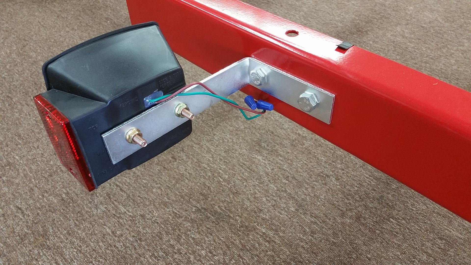

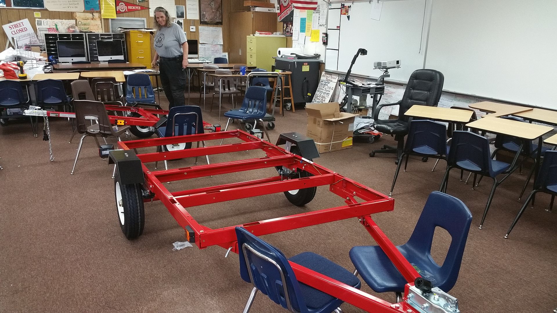

Ok, finished the electricity:
miniaturepeddler
Posts: 25
Joined: Sun Jun 22, 2014 1:46 pm
Re: Hello from Sunny Southern Caifornia
Postby miniaturepeddler » Sat Jan 02, 2016 9:42 pm

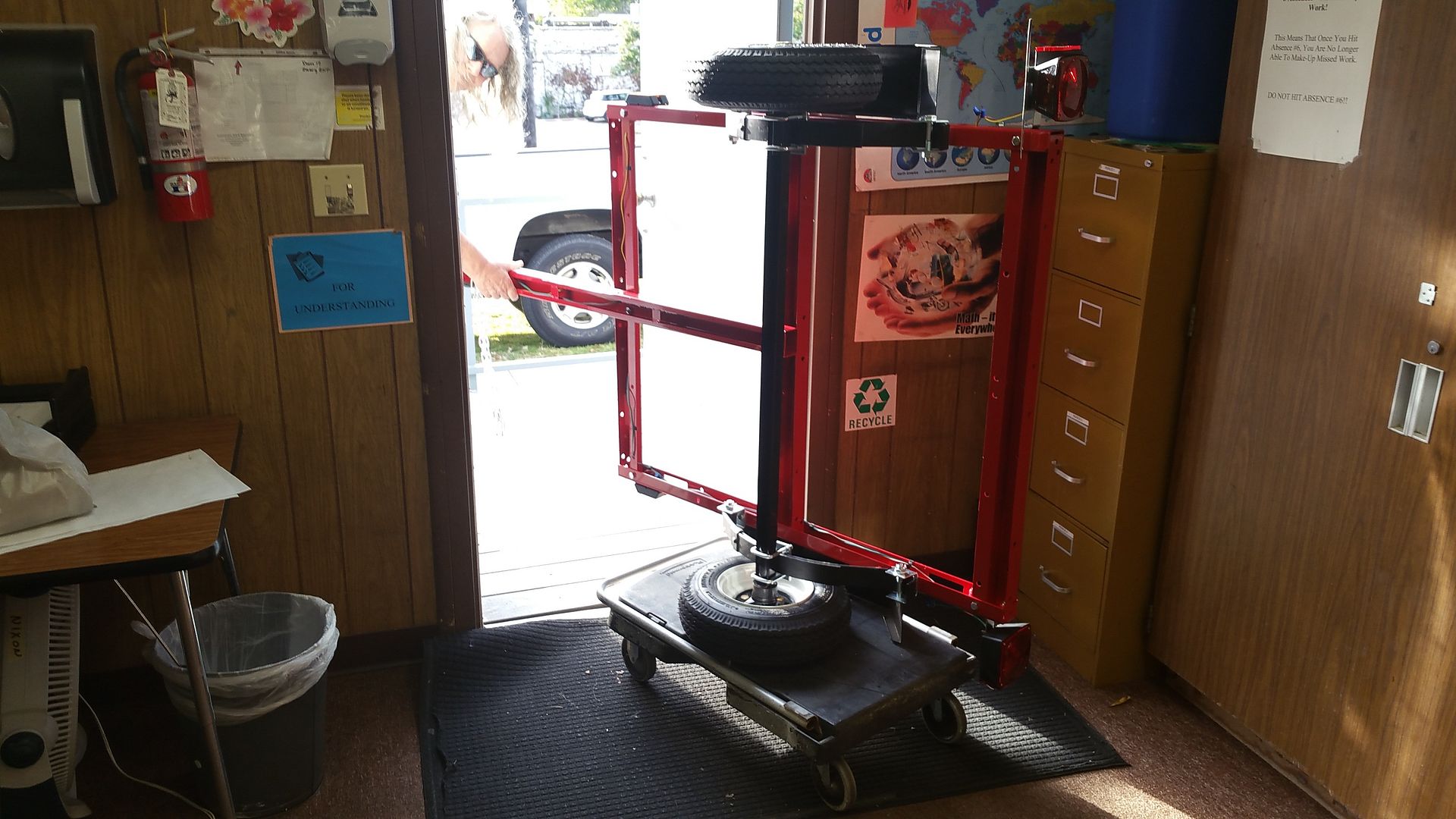

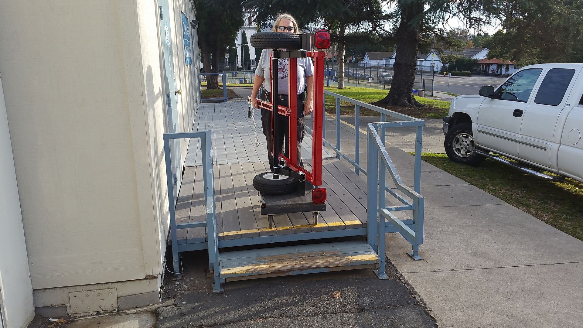

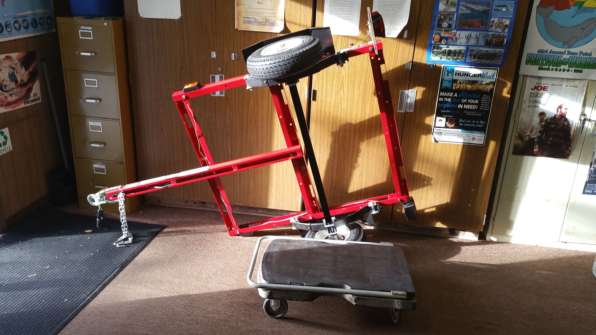

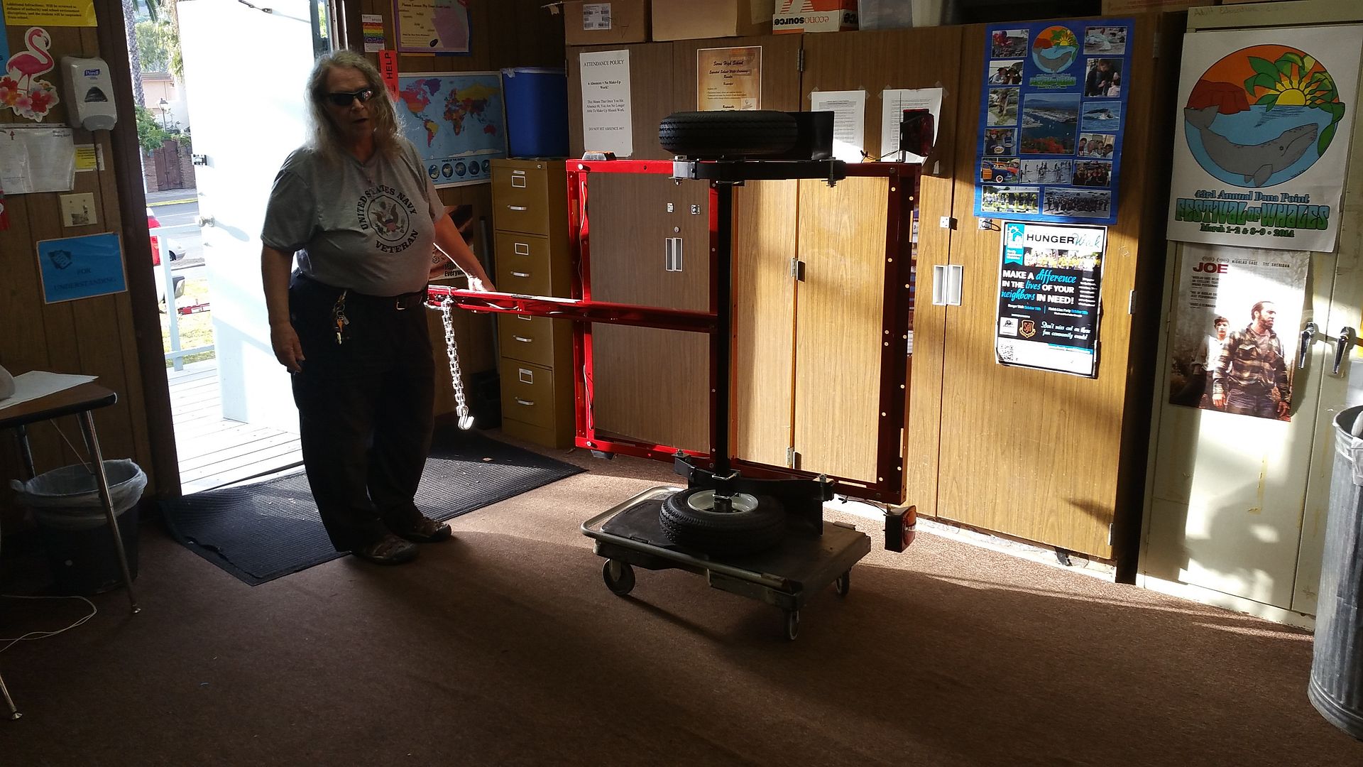

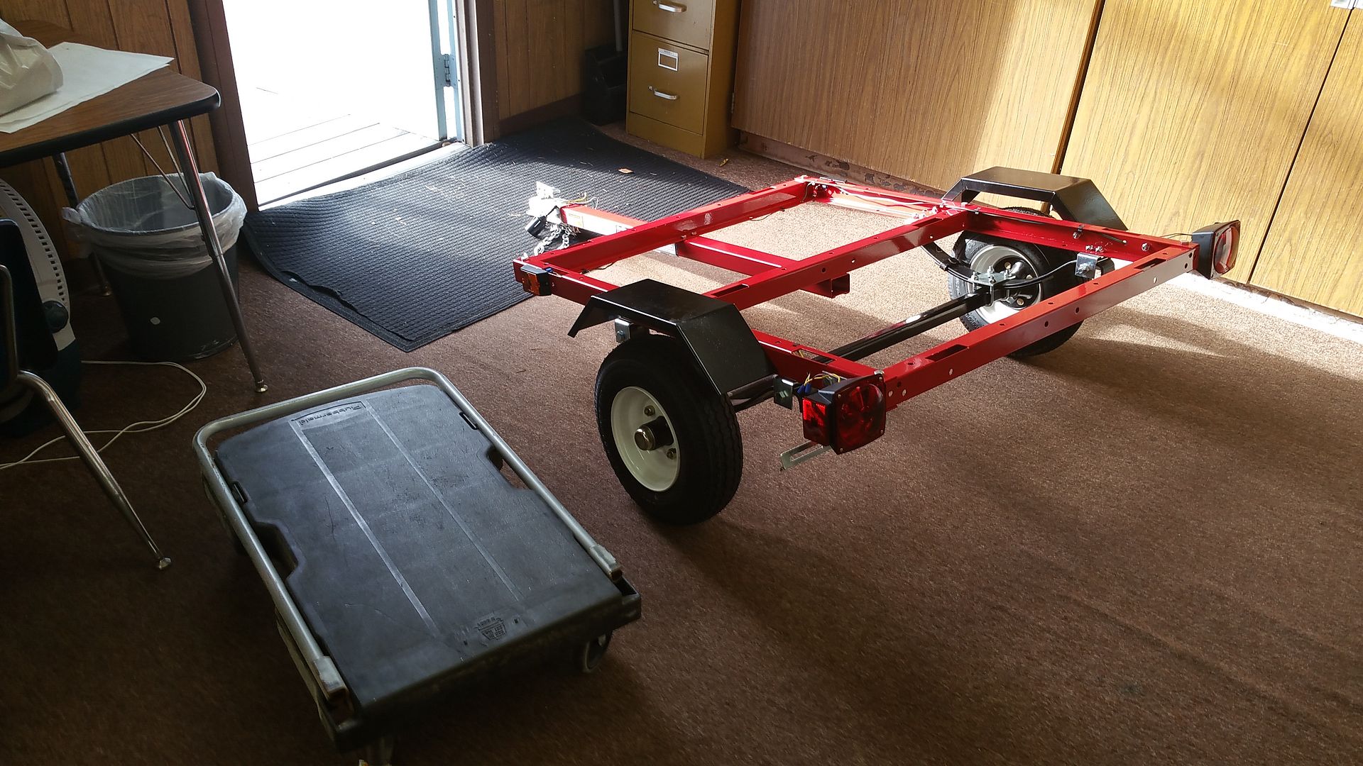

Use a hand cart to help get the trailers out of the room.
Tipped them to their side, wheel and fender on the cart (with it's handle down). Wheeled the trailer out the door onto my classroom porch. Then moved it to the steps. Tara and I were able to lift it down the steps, flop it to the sidewalk onto its wheels and hook it up:

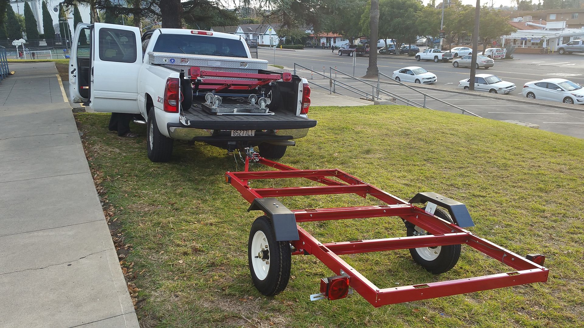

We also build a smaller 3x3 trailer at the same time, so put it into the be of the pickup truck and now we have driven it up to the house and parked them on the front porch of the house, where I shall begin working on them. We have to drive them to the DMV on Thursday to pick up license plates.
Then I can remove the lights and the wiring (that I just did} and begin work on the frame. Then the ral work begins, right?

When you put the light wiring back on. Run a grounding wire to all the lights. Grounding thru the frame is iffy at best. I found that a wheel well be your legs is not as bad as one would think. With a wheel well you can eliminate all that wood under the floor. Unless you are building a very heavy teardrop, you can just extend the floor out beyond the frame. After the walls are all on it will be plenty strong. On my 5 wide TD and a 4 wide trailer, I only used 2" foam with 1/8 FRP(fiber reinforced plastic) for my floor and that worked for me. Except when building you will never walk on the floor. You will kneel on the mattress on the floor. Unless you use a stool when putting on your shoes you want the bottom of the door at a comfortable high so not to cut into the bottom of your legs.

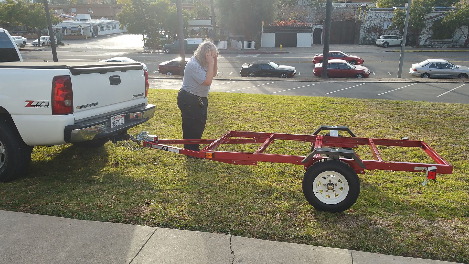

Finally got over to the DMV to pick up the license plates:
Interesting, that a lot of the procedures and costs depend on who you get when you get to the counter.
We had two trailers to registers, so Tara stood in line for the small one, and I did the future teardrop (4x8) Harber freight.
Tara's registration was quick and efficient, No inspection, 40 bucks cash.
My adventure was a little more tedious. The registrar made me go outside for a vehicle inspection. (No problem). Then back inside to another registrar. He did not like my chicken scratch, and my receipt from October was very faded, so I had to fill out another affidavit on the specifics of prices, and location of the build. My cost $42 bucks (what the heck, was the difference?).
But good thing in the end, both our trailers are registered for he next 5 years.
Now to strip off the lights and electrical and get started on the build.
