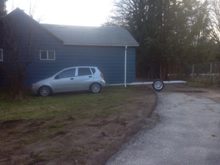

Thanks, Dancam! Your pictures are awesome, if not a bit hilarious too what towing with a small hatch, exactly what I'm planning (although its heavily modified, and has airbags on the rear suspension, so I can dial in the ride height). I'm a long haul semi-truck driver, and am very familiar with the runs to Edmonton and Calgary from Vancouver. I've seen and am very familiar with both the tail addition on vans that clearly reduces drag, and the use of AirTabs (Edit:: or diy twin vortex generator) on the tractor and the trailer. Clearly these save mileage and pay themselves off, or truckers wouldn't use them, especially in Utah and other states where they go faaast! (Edit:: like 76mph) Were all mostly governed at 65mph here. Anywho, I think I will be collaborating with you too, seeing that you clearly have a lot of towing experience as well. Just wanted to say that the 'tail-cone' I'm building is directly inspired by the trailer tail pics you show, and I will be adding AirTabs to both the trailing edge of my hatchback and the trailing edge of the ttt to further encourage laminar air flow. Look them up if you aren't familiar with them, a fantastic simple idea based on creating small vortices of air. Also considering shortening the tongue to snug up the trailer closer to the hatch, but for now it will stay longer as I can fully jack-knife my setup now. That stretchy fabric idea.. what can I say I've never seen that before, but it makes intuitive sense.
Dancam, and everybody else for that matter, one of my biggest concerns was "is this trailer gonna do at least 55mph?" with the measly horsepower of a 4 cylinder hatch, because if it does, this will surely attract some attention on the road! After reading your comments today, seeing your pictures and then including my first test tow last night, I think it might even get to 65. Too bad I can't have access to a wind tunnel, I guess with a rainy and foggy day of the Pacific Northwest and a driver videotaping from behind I might be able to capture where the worst drag is.. something for me to think about anyways.

Is that a Festiva with racing stripes? We have a blue one (no stripes and no hitch).
New to forum - well into an All Aluminum TTT Build
Postby dancam » Thu Sep 08, 2016 6:14 pm
aggie79 wrote:Is that a Festiva with racing stripes? We have a blue one (no stripes and no hitch).
Yup! A '93 with 458,000km. They tow very well by the way. Amazing cars, i love them :)

Can you do 55mph? Well am i missing another thread? All i see is the one photo of the trailer in the first post and you haven't mentioned what the tv is :). Your trailer looks very tall and narrow meaning tippy and hard to handle in crosswinds. But its really hard to tell from one photo. Got any better pictures and what are you towing it with?
I dont haul for a living but i did learn quite a bit while working on a farm as far as how to drive overloaded trucks, what you can and cant do and what happens when you get loaded wrong...
I have towed a lot with this festiva and an '02 civic though. Bigger isnt always better. That u-haul i picked up with the civic, towed it 50km home mostly on the flat. Oil temps went way way up and it overheated and i believe blew a small hole in the head gasket just as i got home. Towed terribly too. Hooked up the festiva and went a couple hundred km to the biggest hills around and brought it back to u-haul with the festiva. Never overheated, oil temps stayed fine, trans and brakes were good. The civic had very slightly more power while pulling it but barely, i still used 4th on the flats a bunch. I believe the festiva also stops faster than the civic with that trailer. Civic is 117hp, festiva was 63 around 26years and 480k ago. Civic has good tires, brand new drums, shoes, rotors, pads- festiva has old stuff and old skinny 12in 145width tires. Also a radiator smaller than some motorbikes.
I had it up to 120km/hr and on an empty highway tried swinging it at 100km/hr and it stayed straight, didnt throw me around. Festiva pulls better than the civic with smaller trailers before this too. Civic 20mpg and festiva 31mpg also. At 20mpg i may as well use a truck. All that to say bigger isnt always better with tow vehicles. We should talk sometime, sounds like you know more about aero than i do. Im going crazy right now trying to get my trailer done. Was supposed to be wrapping up by now and im not even half way done. Id like to talk about what you did to your tv too. I think i have mine figured out, but more ideas are always good. Gonna spend 7months stright working on it to get it ready to tow a 1700 pound trailer (max) across canada 32,000km with 4 people in the car.

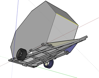

Fred, I just got a chance to go over those links today, thanks again! Typical 20/20 hindsight - had I perhaps studied/joined this forum before the frame build, your input would have resulted in a better design. Well, in a way I am doing a mono-coque approach for the cabin, so that's a plus. I wasn't aware about how it actually would have been better to only 'bolt' the three tongue tubes to the frame and skip the welds. Would have saved time too!
Going back to that sketch for the Northern Lite frame and that build thread of yours, I'd like to share with you the concept drawing for my frame which I did in Sketchup. If you are interested in the file, (Edit::2bposted in the right section). This was my approach to making a really beefy aluminum frame in 'design space'. In reality, I skipped a lot of the re-inforcements, shooting for lowest weight, and didn't run the A tongue tubes to, or past the axle. Having said that since the frame is not permanently attached to the cabin, I guess there's one small advantage in that I can modify it in the future before, and after it fails. In fact, perhaps in a science way it will be interesting to see exactly where it fails so long as I document it for everyone. It could corrobarate what was discussed in those two threads - it appears that you folks were discussing this very stuff in August too... weird co-incidence. Here's the concept:
As you can see I think in math-space I was doing a much better approach, going really beefy with the cross braces, and doubling up the main tongue thickness, running the A tongue tubes all the way back to the end of the frame and doubling up on the cross braces. This design does not have the additional bracing to the axle tube mounts, because I was just making this up in my mind as I went, but they could be added. My design approach to this frame concept was to envision someone 'backing the trailer up at rolling speed directly into a large tree. And use a lot of triangles.
Edit: removed oversized photo with 846 views, added proper sized photo

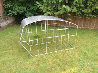

Since this is the build thread, this would be one of the best pictures:
Edit: removed oversized photo with 473 views, added proper sized photo

And I found this older picture today: (i was thinking to beef up the tongue)
Edit: removed oversized photo with 441 views, added proper sized photo
