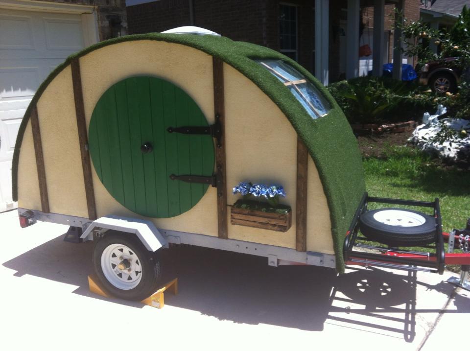

We wanted our doors round too, a hobbit hole door.
We made concessions for the reasons folks have mentioned.
We gave the door one straight edge for hinges. And we straightened out the curve near the bottom so it was more like a square door entry, not so much of the door frame curve blocking the entry. Even still we notice that the botom curve blocks loading a big cooler. The comment about door weight are important -our homemade doors ended up much heavier than standard mas produced RV doors.
Ours look like this. It's as round as we could manage to build.

Tony makes the point of those lower points interfering with swinging in. Valid point. Swing upward (gull-wing) doesn't change it, in fact a little more involved with now something to hold it open). Hinging a round door isn't really all that hard, it's more of the weight of the darn hinge to do it (same goes for round windows).
A lot of good folks here to assist as you go along the build journey. You should start a separate build thread so you can keep track as well as others. Everyone's build helps another's build!

Aguyfromohio wrote:We wanted our doors round too, a hobbit hole door.
very cool and something for me to ponder as I work on the floor layout :). round door is ideal as it's also my logo but if it's too much, I'll skip and design something new to accommodate comfort and ease.

Postby kmack67.km » Wed Nov 20, 2019 2:53 pm
peterlevins wrote:
rjgimp wrote:The round door looks fantastic!
:applause:
Thanks :). Now I just need to figure out how to do it lol
Hobbits have been doing this forever :) I think you need "offset" or "swing clear" hinges but it should be doable.
Good luck,
Kevin
