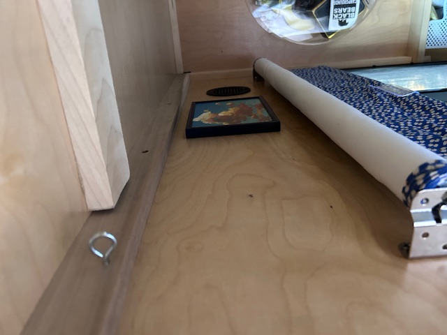

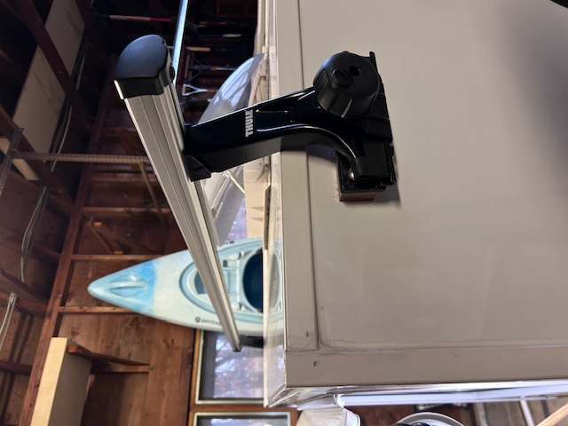

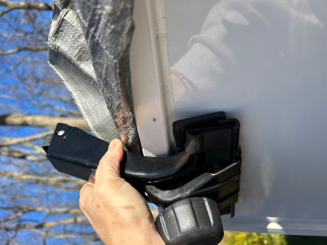

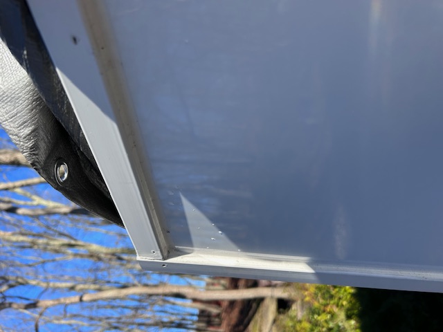

I purchased as you suggested and things are arriving....So here I am stuck on dumb! Well not really dumb just still nervous about installation. I have a few photo's here of my situation, I'd like some input if you could.
So I purchased the 8" feet (thank god I did) I will need to mount the feet and rapid gutter 1" below the top of the camper due to the trim being in the way (attached photo's). In my opinion it appears that I need to bump out the foot bracket away from my camper (add the thickness with a block of wood possibly) so it can lay flush to the camper wall. Also it appears that the inside of my camper has a thicker trim so drilling from the outside in seems risky (attached photo).

Postby Pmullen503 » Wed Jan 10, 2024 12:35 pm
A hardwood or birch plywood spacer is what you need. Seal it really well on all sides before you install (including any bolt holes). Paint it to match the trailer or the bracket. I would through bolt it to the sidewalls rather than just screws. You can use and acorn nut on the inside for a little more finished look.

I agree. You might put all four of the spacers in a baggie with an oil-based polyurethane varnish and let them soak overnight.

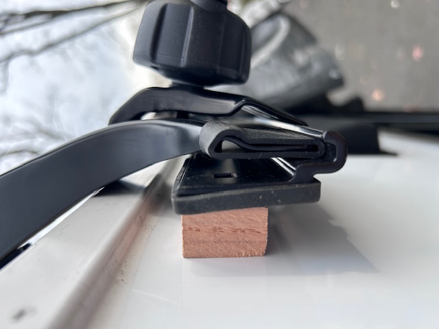

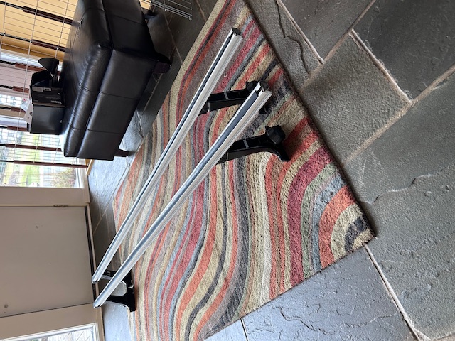

Okay Tony and Paul! all parts have arrived (love gear trade...saved $100 on the crossbars and also $50 on the rapid gutters from there). The crossbars are assembled and I'm so happy that I can trim the ends after installation. I was sweating getting the right length so the endcaps would fit properly. SO I have identified that a 3/4" spacer will suffice. The photo is just an example it's not going to scrape or touch the trim. I have a great piece of wood but have no clue what type it is. It was a dickens to saw by hand to get a sample spacer. I have attached the barcode not sure if there is an abbreviation I am missing that might help in telling me what type of wood it is.

assembled cross bars

In the meantime Mr. Brown (my client) recommended I measure the outside of the camper and then the inside to help me with placement of the brackets (by the way he also suggested I run the bolts through the inside out for a flush finished look).

okay...It's happening! I have installed the 1st bar on the camper and am super pleased with my work. Thank you guys for helping. Tony, PMullen, Twisted lines just to name a few of you. I am super proud at the moment but cautiously optimistic until the full set up is installed.
