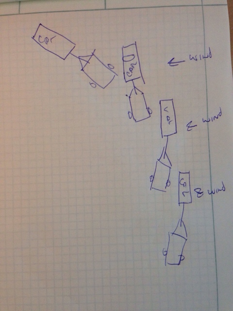

Postby Socal Tom » Tue Jan 27, 2015 6:45 pm
Here's another way to park that provides a perimeter and a wind brake

GreenViking wrote:Thanks Tom, I wanted to understand your words around the teardrop configurations that seem to work best clearer, could you post a simple sketch and snap it/upload it with a camera phone?
I am wanting to ad these thoughts to the designs and am quite the visual learner.
Also finding a way of breaking electric breaks while pushing a TD on uneven ground sounds good and not sure how to engage electric breaks once you have unhitched? Any ideas out there on that?
Thomas
For the brakes, most TDs that boondock have an on board battery. A means to use that to activate the electric brakes could do it. I would install a female ( Tow vehicle) receptacle on the trailer, then when I disconnect the trailer I would plug the male end into that female end. Then I would hook up a momemtary switch that would provide battery power to the brake curcuit when pushed. It would be full on or full off, but that would probably work for this purpose.
