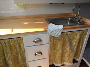

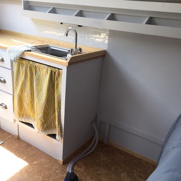

Sink and countertop. The subway tile backsplash is stick on vinyl. The curtains hide the cooler and water tanks.
139 copy.jpg (34.09 KiB) Viewed 1418 times

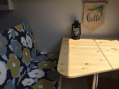

Bench and table
133 copy.jpg (24.32 KiB) Viewed 1418 times

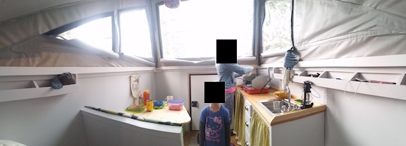

First trip around the block

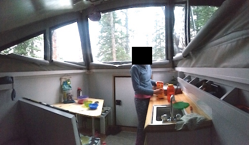

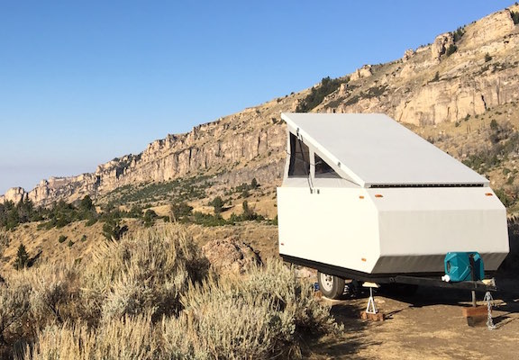

Inaugural trip. It rained. We stayed dry and comfortable. What more could I ask for?

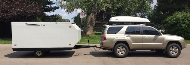

Total weight of the camper is 1400 lbs without food, water, or clothes. That weight includes all bedding, cooking supplies and miscellaneous camp stuff we keep in there. I decided to install a 3500 axle with 15" wheels and 205/75 tires. The trailer rides smoother with the larger tires and with the heavier axle I don't have to worry about overloading or breaking a spindle on a dirt road. I've driven multiple hours at 75-80 mph and the bearings are hardly warm to the touch. It handles great behind my V8 4Runner and has about 13% (180 lbs) tongue weight. With the 4Runner I have no issues keeping up with any speed limit, it's really just a matter of how much I'm wiling to spend at the pump. Average mpg has been 11-16 mpg depending on speeds and wind. I usually get 15-21 mpg depending on conditions. With the upgraded axle the exterior height is about 75" so it fits in the garage with room to spare.

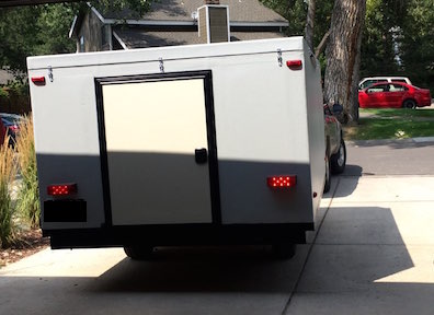

Before axle and tires
144 copy.jpg (41.42 KiB) Viewed 1411 times

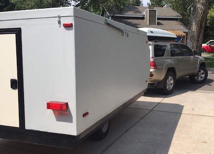

After new axle and tires
IMG_03031 copy.jpg (72.7 KiB) Viewed 1411 times
