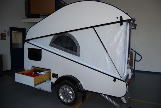

Thinking along the same lines for my truck. Came across this at youtube https://www.youtube.com/watch?v=GmwnBPr7N5A and this pic of a fold up tear? would like to so a combination of both

Those are all awesome! For my planned travels through the jungles of urban America, I want the illusion of walls, so have decided cloth walls are out. The smaller pickup camper has the solid side inserts... :thumbsup:

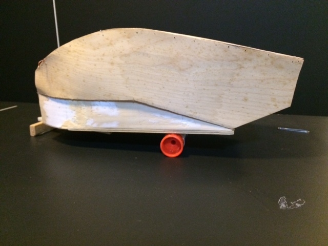

Postby Bluebunny » Sat Jan 16, 2016 5:36 pm
Hi Folks,
I've been in-and-out of town, and like allyall, life gets interesting and slows progress. Just a quick update to show some scale model update. The thing is very unfinished and rough, but gets the shape and simpler concepts shown. I believe building this model will help me with the real-build; sequencing the assembly, challenges in fit and handling, and more...
Assembling the monstrous 5 ft x 14 ft roof and side panels modeled better than expected. One or two forms should be enough to pull it together.
138869138870138871
After some rough stitch-and-glue construction, the rough model form is shown below. The top clam upper front bulkhead has not been fitted.
138874138872
138875138873
One rather large, unresolved challenge will be to invert, lift, and fit the big top clam shell once assembled! Getting fit and function and weather sealing looks to be about like I expected; very do-able...

Your concept is great and it should work. Check this recent video out, for fun - https://www.youtube.com/watch?v=RnWOynlBHfg, but I do not like that their side door does not fit well and no thermal insulation will cause condensation.
