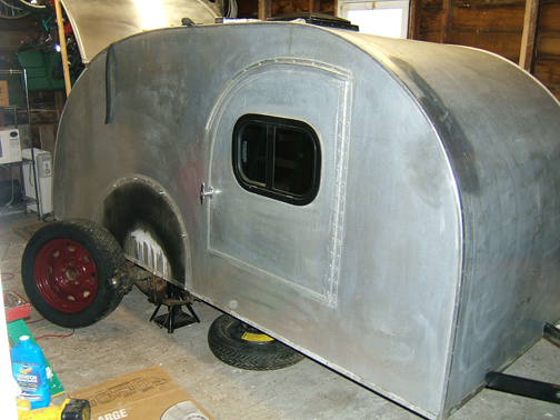

the day after we got her home -- greasing the wheels, starting to clean the siding, evaluating the frame and axle...Do any of you recognize what kind of kit this is? It's an 8 X 10 or so...

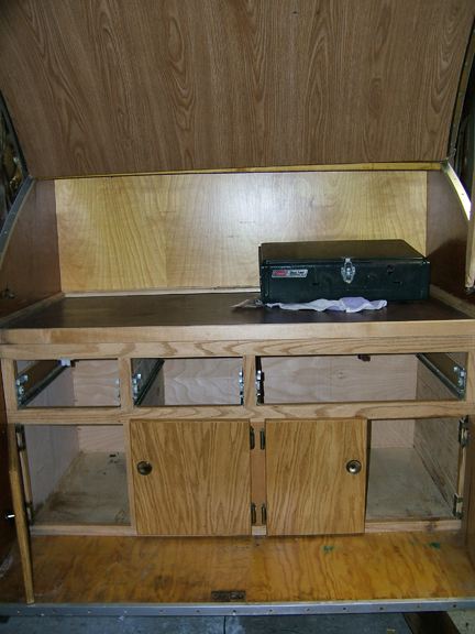

The galley cabinets show some staining. From the stain tracks, it looks like one of the sides leaks, about half way down the side of the galley from the hinge. Also, we're planning on putting some kind of sealer under the galley hinge - maybe an inner tube, as I've read on this site?

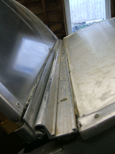

What kind of hinge is this, anyway? It isn't a hurricane hinge, is it? Also, the maker used screws that were so long they pierced the galley ceining by almost 1/2 an inch...is that normal? Should we just put another wooden strip up there to hide the screw tips, or is it ok to use shorter screws??
Here you can see the water stain coming down the side of the tear, from about midway along the hatch edge…The galley is another project – none of our camping equipment fits anywhere! The cabinets are too short and too narrow, for stoves, water jugs, collers, etc. I wonder what kind of gear the builder was going to use?

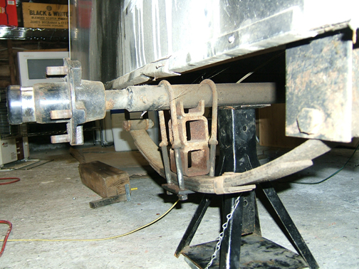

Here’s the last major issue for now. The axle is attached to the frame with these crazy u-bolts, and these spacers are spot-welded together between the spring and the axle. There is a dent in the wood, so you can see she bottomed out at one point. My husband is thinking of cutting out the spacers, and re-installing a single bar, but a shorter one. Does that sound right?
