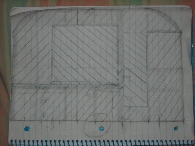

Im still in the planning stages,but i have a good idea of what im going for.Im thinking 6x10x6 with a 3x4x5.5 pull-out side ,mainly because i have a wife and teenage daugter.My plan is to build my TTT seperate from the trailer so i can drop it off to use the trailer.Inside will be a queen size bed platform 2'5" off of the floor this is so we have plenty of storage space under the bed, the slideout will be resting on the platform when in the travelling position.At the foot of the bed will be an 18" door [on both sides maybe] then there will be 18" shelves going across the width of the trailer at the front.Im actively looking for my trailer every day as soon as i get it ill be able to start my build. I have a drawing but i cant figure out how to load it to site from my comp. :thinking: http://tnttt.com/album_ ... c_id=21937[/url]

Image to the playground Patch. A few comments on your plan.
1.. a slide out that big may not like being dropped off so much.
2.. I built my big td on an old pop up frame but you have to be careful to check for level and square.
