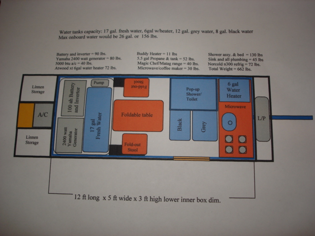

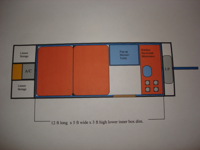

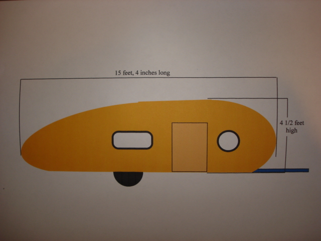

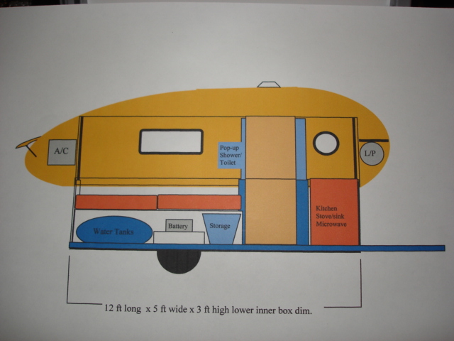

Here's a few basic concept drawings I have, so you can beter understand what I'm trying to accomplish. I'm sure the final product will look nothing like this first prototype, but you've got to start somewhere, right?
This is what it will look like with the pop-up down.
This is a cut-away with the top up.
Here's the floorplan with the bed folded.
Here's the floorplan with the bed extended.

As far as gas mileage goes, right now my car gets 41mpg at 45mph, 35mpg at 55mph, and 32mpg at 70mph unincumbered. I'm hoping for 30mpg at 55mph with trailer in tow on near level road.

I wouldn't tow anything as large as 15ft with a Cobalt, even an empty flatbed. The TV just doesn't have a long enough wheelbase and weight for something that large. Your proposed plan will probably surpass the GCWR before anything else.

Postby sushidog » Sat Jun 09, 2007 3:55 pm
asianflava wrote:I wouldn't tow anything as large as 15ft with a Cobalt, even an empty flatbed. The TV just doesn't have a long enough wheelbase and weight for something that large. Your proposed plan will probably surpass the GCWR before anything else.
Thanks for the advise. What would you advise as the max length I should tow with my little balt?
The actual trailer/living area I'm planning on is 5'x12', the rest of the length is just for the light weight aerodynamic topper. I understand the principle of mass centralization (keeping the bulk of the weight near the axle) and am trying to lower my center of gravity as much as possible by using the pop-up concept.
Do you think a 6'X10' trailer would be a better base to build off of? I'm trying to avoid the extra foot of width, as my car is only 5ft wide and 5'5" high. This extra foot of width would greatly increase my drag and subesquently gas mileage loss.
The vehicle's max tow rating is 1000lbs, however I've heard that in Europe the tow rating's are roughly twice what they are here for the same vehicles - basically for product liability/warranty reasons. I have the same transmission that GM uses on their 6cyl cars, plus I plan on adding a tranny cooler. I've already had the ecm and tcm flashed for better performance. I've also added full boltons to up the hp from 173 to about 200. I've got the beefy sport suspension package and 4 wheel antilock disk brakes for safety. Plus, I plan on electric trailer brakes to help stop this extra mass.
Is there anything you can think of adding to help my car tow a long/heavy trailer safely? Is there something I'm missing?
