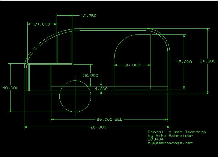

Here's a Benroy I drew for another really tall person a few years ago...
Postby shoeman » Sat Jul 07, 2007 7:57 am
I assume that width can be varied according to need? A 5 footer will fit a queen mattress and I think that's what we want.
Nice drawing Mike. Thanks!
