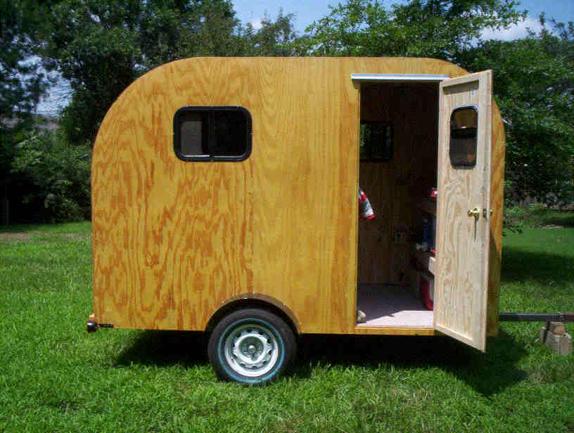

Like Pat says, it looks like you've got a standy there... similar to the Puffin that Steve Wolverton built.
While it's practical enough, it don't see much in the way of a galley in there.
If it's early enough in the design phase, you might consider adding a galley, either inside or outside.

Just a couple of thoughts about your camper. I like the layout (mine is very similar and works well) but bunk seems a little off. It's a real pain moving things around inside these small campers, and it looks like you plan to store the bunk near the bathroom during the day. (Is that a bathroom?)
I would have the bunk above the main bed, and you could even put it on a hinge that so that it would tilt up during the day for extra headroom.
Another option would be to have two smaller bunks on each sidewall. They could be tilted down for sleeping at night, and your kids would have their own bunks.
