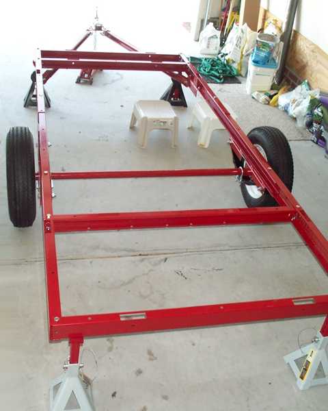

Got the frame started -- and stretched -- springs reversed -- axle sub frame is built and positioned -- but need to calculate real location before I start drilling holes.

Postby Ira » Wed Sep 05, 2007 2:23 pm
You're putting another cross member there, right? And the one way in the rear isn't attached permanently yet, correct?

500lbs of gear
Postby LesterS » Wed Sep 05, 2007 6:18 pm
So maybe I have a tendency to exagerate - slighlty. :whistle:
Maybe 300 lbs of gear if you include bikes and provisions.
As far as crossmembers go, there will be others that will be added from the sub floor, but I wasn't planning on adding any more steel. The frame's been doubled up where it's been 'stretched'. (And any gaps will be filled with angle to match.)
Right now, I'm struggling with just how far back to place the axle - I'm leaning to 42% to 45% from the rear. My reasoning is the finished trailer will not have a rear kitchen, but a interior kitchen area (much smaller), plus there will be a pottty area. The whole back is going to be a bed.
I've kinda scoped out some other designs trying to see the axle placement, but there's less to go on here for a TTT. Most of the info on axle placement is for a rear-kitchened teardrop.
So I forward this question: Just how far back does the axle need to be on a canned ham,widget, midget, or puffin? (Thanks for the inspiration Steve).

Postby ARKPAT » Wed Sep 05, 2007 9:45 pm
Lester
Welcome! :thumbsup:
You might check with Andrew about the balance he has a program on the site to calculate tongue weight and you might play with it to placement of your axel.It realy depends on what you put ( gear cabinets walls material used ) in the trailer and where it is placed in the trailer with respect to the axel placement. :thinking:
I like you idea of the stretch as long as you make framing to tie-into the frame to strenghen and support the rolling frame itself. ;)
