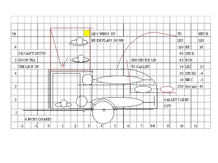

I have drawn a few lines in excel, (we use cad at work but for fast lines when you dont know what your doing til it's done draft tools in word or excel go quick) I made a Jpeg out of it so ai could post, it's not as clean as i'd like.
(the pic is better but still no good in the album)
My list of specs for the impossible trailer:
Total LBS 350
Hitch lbs 45
Holds 6 (2nd deck + 2 cots)
Pop up so I can dress standing
82 MPH for several hrs (Reno to Wells)
Under 4ft3 when top down (so I can see out the back)
Hatch & minimal galley (so I can call it a TD)
Some insulation (camp in Idaho winters sometimes)
When camping in the wild we will add a tent for the Kids
When stealth camping in towns we can all fit in TD
When in the super cold we can all cram in two decks and leave the top down
( we fit 6 and my 23yr old brother=7, in the VW for a week of Mexico vacation.
I’ll try for a better pic of the TD design but what do you all say?

Postby Ira » Fri Sep 28, 2007 2:38 pm
Jason, welcome--but you can make your photos bigger.
I think you're following the avatar size limitations, but pictures you place in your post can be 820 (pixels) wide by 652 high. Just don't go over on EITHER of these dimensions and you can upload it to your album, and place it/them in a post.
And keep it under 360K, so if you're saving as a JPEG (which is what you should be doing anyway), just adjust your jpeg quality setting to bring it under 360.
But you know what? I think you guys need a Vardo with a group that big. If it starts raining big time, you don't want those kids in a tent away from you.
Who here has those cool Vardo links? Plus that guy in Pennsylvania (I think) who offers the kit, as well as the plans alone?
Now THERE'S a cool trailer for a big family.

Postby jason mundt » Sat Sep 29, 2007 12:04 am
Thanks for the help with the pic size.
I figured it out, you have to get your link from the "big pic" not just the little one in the album.
So I supersized my family "honey I blew up the kids" in my original Hello post.
AND got my line drawing bigger. Still not clean but better.
the box rotates up like the back hatch and while that happens another flap comes down to fill in the oly gap.
It has some guesses as to the LBS I'm hoping for.
The red lines are where stuff rotates to or pulls out from.
I think I'll try to put together a practice panell this weekend to see how luan and sticks glue and clamp.
Also had some fun looking at "Vardos" due to the suggestion above. My grandma in idaho has a old sheep camp we slept in as kids, the old wood wheels are too woobely anymore for it to move out of the shed but I'll get a pic of the inside of the old thing it's still very nice.
Jason
