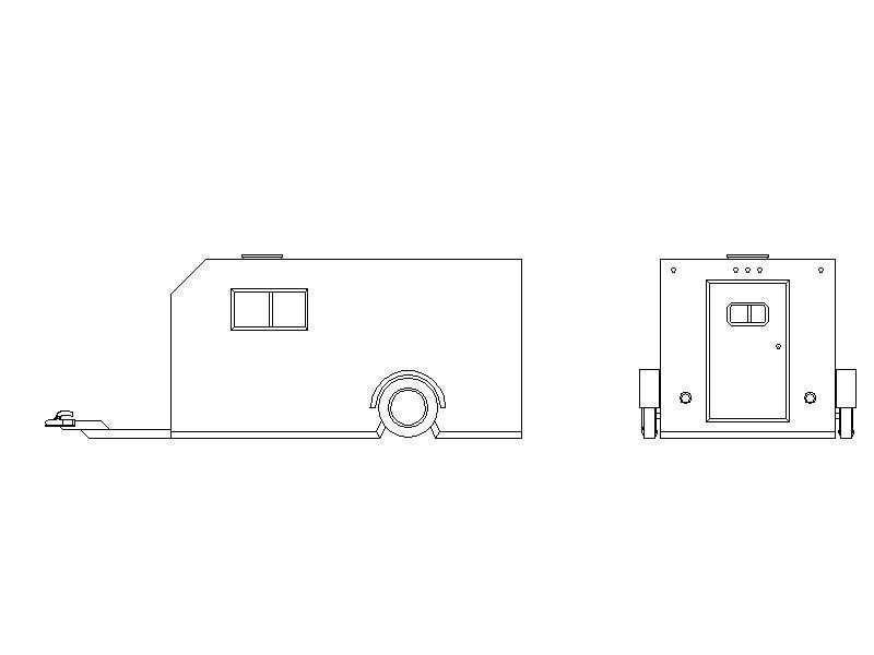

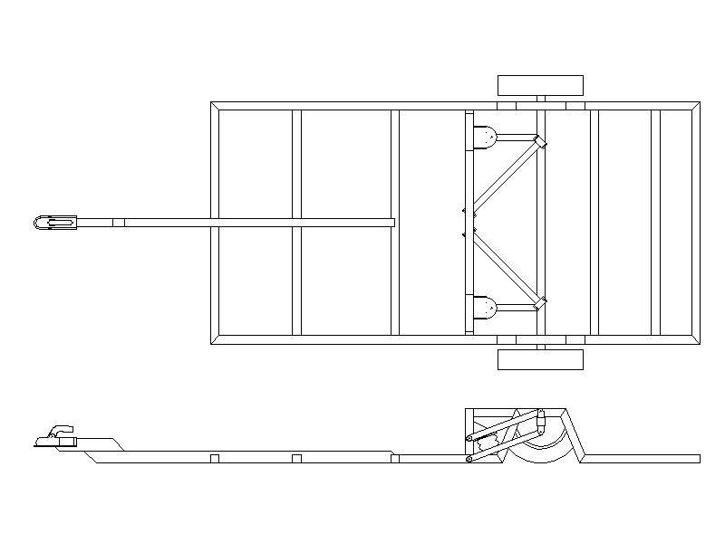

So this is were I was posed with a challenge, to build a camper that would be small enough to be towed with my '93 Toyota pickup and for it be "cool" enough to be presentable at a truck show. I have included some "first draft" drawings showing my ideas.
I decided on a 5x10 Simple, rear entry, no galley, foot well/dinette, sandwich construction, all 12V, air bag suspension, CPES and black automotive paint. I would like to make this a winter/spring project but some financial issues have kept me from starting but the frame should be finished by the end of December. Wish me luck!
Be gentle these are just simple drawings to get my ideas on paper. Any input would be greatly appreciated.

Glad you found the forum. Nothing wrong with the drawings, I think they look really good. Since you've got an idea of what you want to do, then jump on in and get started. Ask lots of questions, we like questions. And when you start your construction, be sure and post lots of pictures to keep us updated on your progress.

To the playground. Truck is great and will look fantastic with a tear behind it. Sounds like you have a good start on it. I wonder if you are going to get it as low as the truck and how tall it will get. 5x10 is a good size. You might also take a look at the escape hatch if you want height without being too high for the truck.

I have just started looking for the basic parts to build the frame. I have a 1 7/8 coupler, 2000lb axle/hubs, a wiring harness and 2 1500lb air bags on order.

One question I do have is about the tounge size. Will a 2x2x1/8 tounge be stong enough for a 5x10?

I would use 3/16" wall tube for the tongue member. Everything else can be 1/8".

Thanks Mike I'll be sure to use that.
