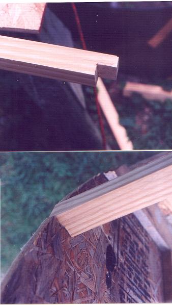

2X8 2X10 AND 2X12 lumber is in most areas are Southern Yellow pine. Ask for #1 grade ( almost knot free ) The SYP is approx 50% stronger than Spruce pine fir (most 2x4 and 2x6 are SPF #2)
I ripped my spars 1 1/2 x 1 1/2 and my tear is 5'7" out to out. I spaced them at 12" on center. After you rip them down let them rest a day or so. There is always some grain release that occures in ripped lumber and they may develop a twist or a bow. I cut 4 extra and the rejects were cut into short sections and were used to frame my cabinets. I cut a rabbet into the spar and a pocket in the wall and was able to screw thru the side upward into the spar. They were also glued for extra strength.
