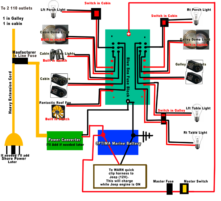

here is an example drawing of my electrical plans. I haven't looked to see if there are others out there yet. This is just from the head of someone who grew up with an electrical engineer as a father.
Feedback would be appreciated. Thanks!

Ok, I have to ask. You have a shore power listed on your electrical and are doing a back woods trailer. Would it make more since to use a solar or wind option instead of shore power?

Excellent point. This is why I put this diagram out for critique. I am making some assumptions.
I have a solar panel that will feed into the battery via the 12v line that I run from the Jeep's alternator (I need to add that line to my diagram). The line will clip with a WARN quick clip so it will be easy to attach other accessories to it or other methods of charging.
The 110V line is just a matter of convenience in case it is needed or I can maintain my battery during the off season just by plugging it in. Also, I don't plan to put the 110v part of the system in until next summer some time (I want to see if it is even warranted). But planning ahead on my drawing never hurts.
Good feedback. I've revised my diagram to include the 12v Jeep harness (below).
