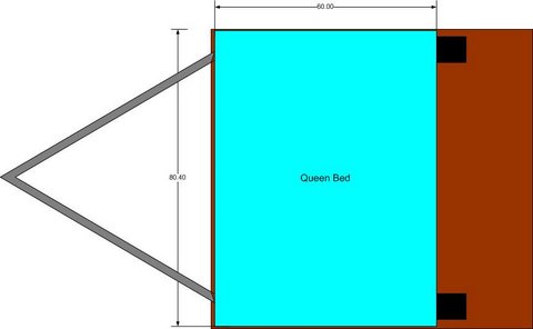

as promised
Postby gager2002 » Tue Aug 12, 2008 1:01 pm

Postby Miriam C. » Tue Aug 12, 2008 8:20 pm
Image to the biggest playground around. I built mine on an old pop up and love it. Made the double bed across the 76" wide and it is fine for us. Mike is 6'1" but rarely sleeps straight out.
Part of me wishes I had put the bed over the wheels and walled in the potty. One of the things I did without thinking is put the vent too close to the bed and that gets in the way of the sliding wall I wanted, again to block off the potty. Here is a picture or the bed which will some day be a table platform.
