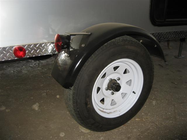

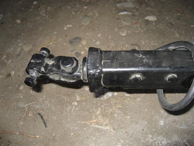

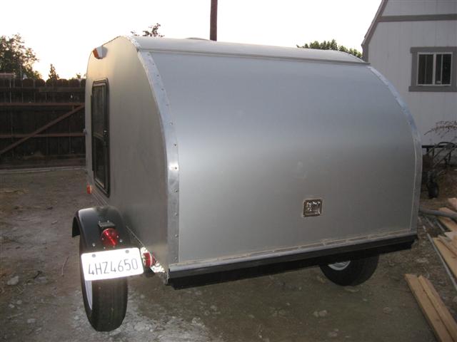

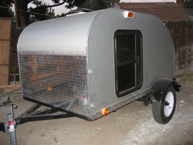

Postby bluzharp » Wed Aug 20, 2008 2:17 pm
We're getting closer to finishing this project every day. There are a few more pics in the album but here are a couple from this weekend's work.
The fenders and running lights are done!
Here's a shot of the trailer end of the LocknRoll Hitch
Here are the back and front views.
