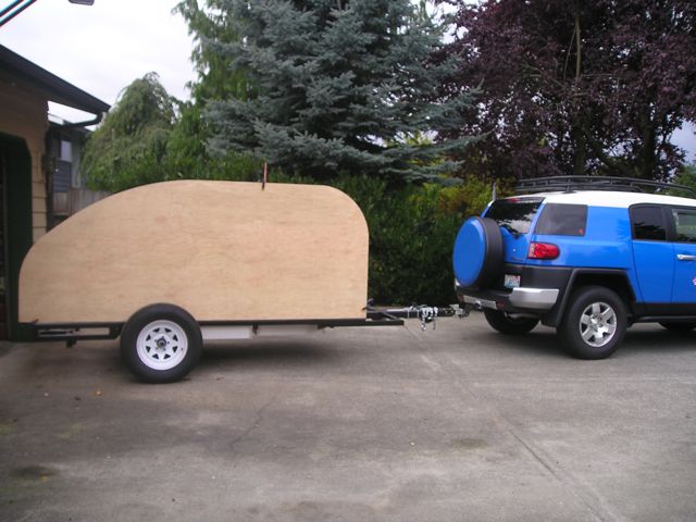

My name is Buff Little and I have never built a Teardrop before, but I am having a great time working this thing out. We are long time campers and until recently had a pop-up tent trailer. Now that our kids have grown, and we don't need multiple bunks, I just knew that a teardrop was the right choice for us.

I started my in depth research as soon as we got home. I welded the frame over the Labor Day weekend and have been getting in a few evening hours each week and most of my Saturdays are being gobbled up. This thing is my OBSESSION.

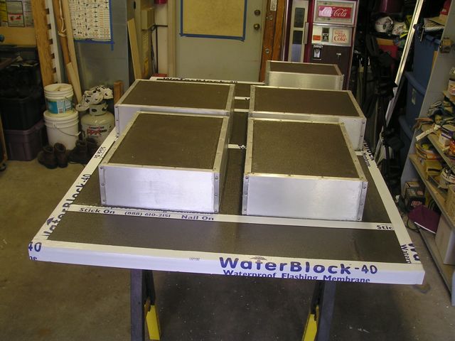

I know from all of your replies to newbies, that you WANT TO SEE PICTURES. So I waited to introduce myself until I figured out how to resize and post pictures for you. So here they are. My build is a 5x10 that in no way could be considered light weight. I will be towed by a Toyota FJ Cruiser and we tend to camp in non-improved areas, so it will have onboard water and lots of battery capacity. The axel is a 3500lb Torflex, de-rated to 2500lbs to cushion the ride.

Postby Hector » Sun Nov 23, 2008 4:11 pm
Well Buff some one has been busy.I got a feeling you will turn out a great product.Keep up the great work and keep the pics coming.

Image to the playground. Wonderful start to your teardrop. I love the trailer and the storage boxes.
Just wondering what a "water block flashing" is and where to get it.

Miriam C. wrote:Just wondering what a "water block flashing" is and where to get it.
When I lived back up North, we called them water dams. It's just a big rubbery kind of sheet that goes down before you run the first rows of shingles on your house. The idea was that ice and snow that melted from the houses heat and re-froze when it hit the gutter wouldn't back up under the layers of shingles and get to the sheathing underneath. Don't know where to get it down South; but up North it's available wherever they sell shingles and roofing. :snow :snowstorm:

Waterblock
Postby Playtym » Mon Nov 24, 2008 6:57 pm
I don't know if I am responding in the correct method, but we'll know soon.
Hi Aunti M, The Waterblock product i am using is a flexible flashing membrane that is very sticky rubber under the facing sheet. The rubber seals around any nail or screws that pass through it. It is used around window and door openings in a lot of new residential and commercial construction. I thought it would be a good way to seal the area where the floor box fits into the surrounding Aluminum T. I also have used it to isolate the aluminum under floor from the steel of the frame. The only actual place where there is a physical mating of the aluminum and the steel is through the floor bolts. Since it also takes moisture for any electrolysis to occur, I thought the water block would be a good product to seal the bolt penetrations. If that isn't enough explanation, here is the website for Waterblock. www.waterblocksystems.com There are other brands on the market, this manufacture just happens to be the Seattle area.
Thanks for the interest. Buff
