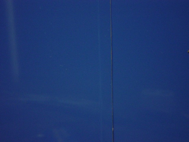

Welcome to the forum. I see the local Marine Supply Company has marine plywood in 5x8, 5x 10 and 5x12. I haven't priced it because I am afraid, but it is available. Not really necessary because you can use several methods of joining 4x8 sheets. Sheet aluminum is available in 5x12 sheets for an exterior or just lap it like I did
Jim
