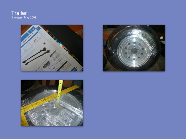

So far, so good. Now I can calculate what size of Dexter axle to purchase. With this wheel (and this is where I can use some help checking my math), I've measured 4 1/4 inches from the interior rim where the hub would connect, to the top of the tire. ( I did this before I shrink wrapped the tire.) I want to calculate the required "hub to hub" dimenions. The axle brackets from outer edge to outer edge will be 5 ft or 60 inches. To that 60 inches I would add 4 1/4" plus 4 1/4" making it 68 1/2". To that I would add the thickness of the trailer sidewalls, 3/4" x 2 = 1 1/2", so now we are up to 70 inches. Of course the tire needs a little breathing space, so I would add another inch or 2 to each side. Say we split the difference and make it 1.5" on each side between tire and trailer siding. That would bring the distance from hub face to hub face to 73 inches.
Does this seem about right to you guys? These tires are 205/75D and are about 7 1/2 inches wide. I figure with 1 1/2 to 2 inches between the tire and the trailer siding, a 10 inch fender will look great.

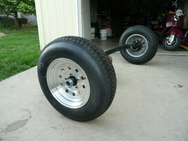

The Dexter #9 axle came in today. Looks good with the wheels. Tomorrow I haul it 2 blocks south to the welders. A couple of young guns that build some amazing stuff. They say a trailer will be easy. I have confidence in their skill from what I've seen.
I guess this is like jumping out of an airplane. No turning back now! :?
I think I'm off to a good start. The hub face to hub face of 73" gives me excellent tire clearance from the torsion bar, and an 11" fender will fit perfect.
