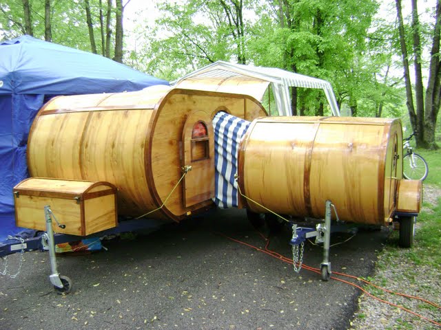

Postby Jst83 » Mon Aug 17, 2009 7:58 pm
I believe you can tow with a Scion The guy pulling these 2 has a 4 cyl in his and has no trouble. They've been to a few of our gatherings with there tandem
Jst83
Posts: 3606
Images: 215
Location: Indiana, Greenfield
Postby Rvankeur » Tue Aug 18, 2009 7:30 am
Jst83 wrote:I believe you can tow with a Scion The guy pulling these 2 has a 4 cyl in his and has no trouble. They've been to a few of our gatherings with there tandem
OK, I've seen that picture before - who sleeps in the little one? And where in the country is towing two trailers legal (other than the tractor trailers with the doubles)?

Postby bobhenry » Tue Aug 18, 2009 1:52 pm
Question 1 Mom and Dad get the big one and the 3 kids are in the other. They pull them side by side and have a walk plank and a nylon tunnel runs between them.
Question 2 Alaska , Arizona , Colorado , Idaho, Indiana , Iowa , Kansas , Missouri , Montana , Nebraska, Nevada , North and South Dakota, Ohio , Oklahoma , Oregon and Utah

I found the pictures from our spring Raccoon Gathering
Postby Rvankeur » Wed Aug 19, 2009 2:55 pm
Those pictures of the tandem teardrops and their occupants are great!
Beautiful rigs, but from the list of states where that's legal, I won't be seeing them crusing I-95 anytime soon. :lol:
