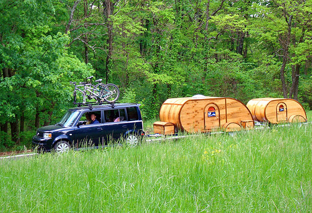

Postby prohandyman » Tue Jan 05, 2010 10:00 pm
You could always build two....I think there are 5 in this family

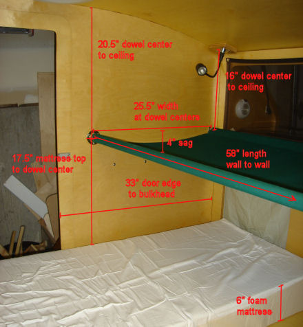

Postby S. Heisley » Wed Jan 06, 2010 2:56 pm
You might want to take a look at this idea, too:
http://tnttt.com/album_ ... c_id=24765
Posts: 8869
Postby ai4kk » Wed Jan 06, 2010 4:20 pm
That's cool. That looks about like a VW Camper hammock.
