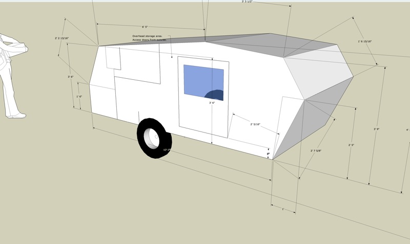

Postby figuarus » Tue May 04, 2010 4:59 pm
well, i've just finished drafting the trailer layout, and at the moment, only have the actual box's side walls dimensions laid out.
the trailer frame im working with is an old 14 ft camp trailer that someone abandoned up in the mountains near utah lake, and will make a fine base for this particular project.
from hub to hut, its just under/over 6 feet, and is just over 13 feet long. the frame does have two bends near the nose that will be perfect for mounting a tongue box onto.
since i got the trailer for free, (well i had to spend gas money to go up and tow the dang thing home) im projecting a total project cost of less than 350 bucks. im going to attempt to freecycle as much of the base materials i will need to get this done.
here are some pictures of my design and trailer
Sorry for the crappy pics. all i have left is a cell phone camera!

Postby GregB » Wed May 05, 2010 10:28 am
Great looking whitewall, there. Not sure, but that frame looks like it has 4 leaves in the suspension, which might be enough for 5,000 lbs. I'd check with someone who knows, but I'd recommend taking two leaves out to compensate for the very light weight of your trailer (under 1500 lbs). Good luck with your build.

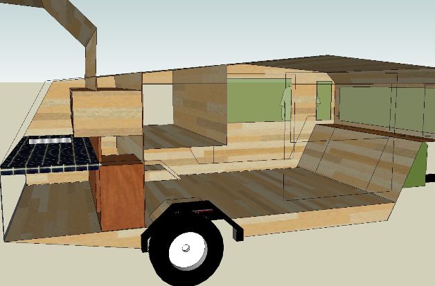

Postby figuarus » Thu May 06, 2010 7:59 pm
well, so far, i think this will be the final design (more or less)
the rear end will contain just a small area for a camp stove, a cooler for food, and some storage for misc stuff. inside, the bed will be a comination slide out/ flip down bed that is divided into 2 foot sections. overall width has grown about 5 inches on each side, so it will sit over the wheels instead of in between like i had originally planned. im debating whether i should mount a box on the tongue for more storage and tools. i have to keep in mind that this trailer has to be LESS than 700 lbs when done so that i can pull it with my little LUV pickup.
suggestions? this is my first build, and have never undertaken a project of this magnitude, so ANY help is greatly appreciated!

Postby GregB » Fri May 07, 2010 8:53 am
You'll need to move your axle back, I think. Even though your galley will be pretty light, the trailer will track better. The Design Library at the top of the page has a spreadsheet that will help you decide on exactly where to place your axle.
