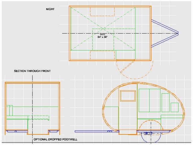

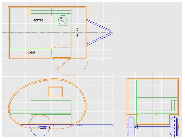

I guess I am the 'Widget mastermind', though that's not how I would put it.
The name Widget comes from Winter Midget - the idea was to build a miniature standy (well, nearly-standy) based on the lovely Midget shape (see the vintage plans), but with the galley inside. Here is the Widget 1 which is just the Midget body with different interior:
Widgets 2 to 7 were just developments of this design for different reasons - for example, the Widget 7 was a custom variation for Bev Traxler that put a Widget 6 body on a pop-up trailer chassis. But it's long enough ago that I can't tell you what the 2 to 6 variants were!
Along the way, a few practical features crept in, that moved it away from the 'ideal' egg shape of the Midget - putting some height over the galley was one and making the floor and frame longer (without such a 'tucked-under' body) was another.
Andrew
