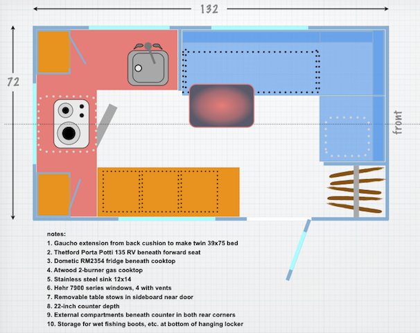

Postby myoung » Sun Aug 08, 2010 11:28 pm
I too have caught the bug. We have a 25-foot Airstream, but there are many occasions when I'd like to head out for a couple of days of flyfishing, photography, or just exploring...alone.
I used to do this in our trusty VW Westfalia Camper so I'd like to get back to that scale and the freedom it offered. So, looking around at the many TTT variations, I decided that something much like the VW where standing headroom is a sometimes thing and stooping or sitting or sleeping are the most common postures.
I was most pleased to find the Compact III design and discussed some modifications with Andrew. Here is my first attempt at sketching out the floor plan for a 6 by 11 foot version of his Compact III. The major changes are relocating the door from the rear to the curb side and creating only one bed which extends to 39 inches Gaucho-style. The sideboard is for storing all my photographic and fishing stuff.
Comments and critiques are more than welcome.
Mike Young
myoung
Posts: 644
Images: 250
Location: Nipomo, CA
Postby Cliffmeister2000 » Mon Aug 09, 2010 8:34 pm
That looks well thought out! :thumbsup:
One thing to consider; if you can make the bed at least a full size, the value will be much greater if and when you need to sell it.
God Bless
Cliff

Postby glassice » Mon Aug 09, 2010 10:48 pm
Looks good . May I ask why move the door I am a big fan of the Compact Jr

Postby myoung » Mon Aug 09, 2010 11:19 pm
Cliffmeister2000 wrote:That looks well thought out! :thumbsup:
Thanks for the compliment, Cliff. It is fairly conventional in most respects. I wanted an open feeling with good seating and minimal hassle when making the bed, thus the gaucho. I doubt I'll use the small table much. Also, I like the continuous counter space in the kitchen area where standing room is best utilized.
As far as I know, a twin bed measures 39 x 75 and full bed measures 54 x 75. With only 69 inches of interior width, a full size bed would consume almost all the front floor area, leave almost no room in front of the door or between the bed and the sideboard, and would make the hanging locker width less than 10 inches wide. I'd rather roll out of bed sideways than crawl out over the head or foot. Having some floor space to move about even when the bed is extended is more comfortable and convenient for me.
Lastly, my intention is that this will be a one-person trailer. We have the big silver twinkie for extended trips with our dog. I just want a comfortable getaway pod.
Mike Young
myoung
Posts: 644
Images: 250
Postby myoung » Mon Aug 09, 2010 11:36 pm
glassice wrote:Looks good . May I ask why move the door I am a big fan of the Compact Jr
Some of my considerations are mentioned in the immediately prior response. I could have gained more counter space by splitting the galley, but then the hanging locker and the head would have to be relocated. I'd also have to move the sideboard storage area further forward.
Having had a VW Westfalia and now an Airstream FB colors my thinking about floor space to move about. Both have side doors, which seems more natural and convenient. Notice that I also have pushed the width of the Compact to 6 feet to gain this extra roominess. I like the large, unobstructed wall along the curb side. I think this should make the diminutive trailer seem larger.
Lastly, the two rear corners of the kitchen that would be hard to access from the interior allow decent sized cargo compartments. One will probably contain a gas bottle and the other will probably house water and grey water unless I can fit these below the sink and then could use the space for other storage accessible from outside where I could keep water hose, filters, and electrical chords.
Mike Young
myoung
Posts: 644
Images: 250
Modification 2: Galley in front
Postby myoung » Sun Aug 15, 2010 8:21 pm
Already, I have created what I think is an improvement upon this modification, namely one that moves the galley forward. Here is the floor plan and I will post progress on the Member Designs section under the subject title "Compact III -- New Modification w/ front galley."

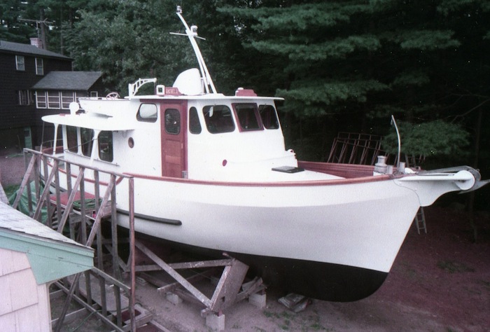

Rachel J

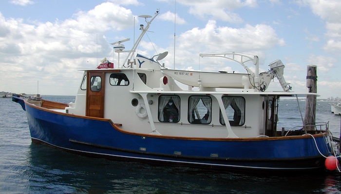

Postby myoung » Mon Aug 16, 2010 3:34 pm
Steve, et al,
Here's a photo of the Rachel J at the Volunteer YC in Lynn, MA. 44-feet of homebuilt love by my parents. Still plying the Intracoastal Waterway owned by my second cousin and her husband.
Mike Young
myoung
Posts: 644
Images: 250

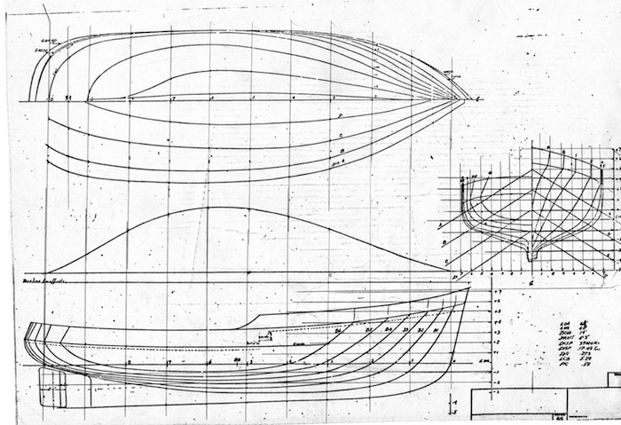

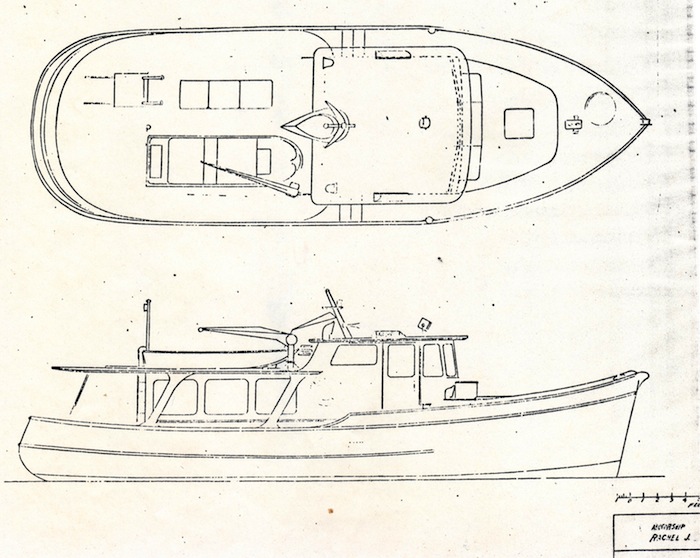

This is the lines drawing that we stretched by 2 feet when it was laid up. It just looked better with length added to the bow.
Here is the profile and plan drawing. These are the only drawings that were created prior to construction.

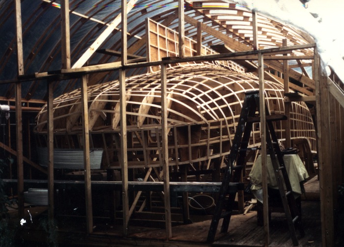

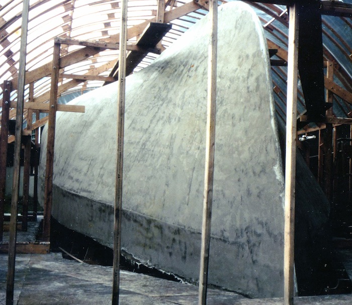

First, we created a male mold of stringers upside down.

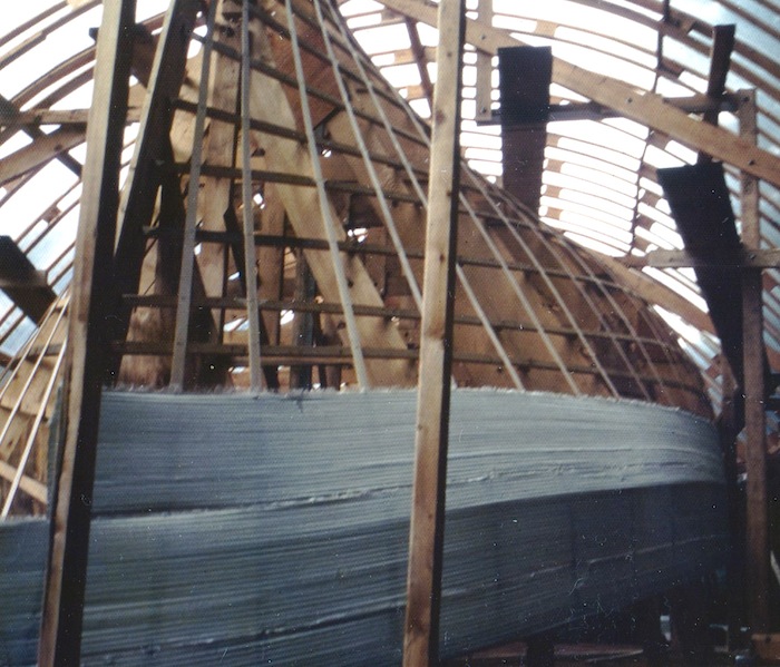

The first layer that set the shape was a comprised of strips of fiberglass bundles about a foot wide.

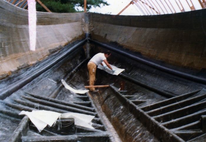

Here is the final layup including layers of fiberglass mat and woven roving, way over engineered.

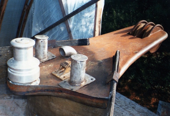

Engine beds and other stringers that are plywood, wood, or split PVC pipe all covered by fiberglass added greatly to the strength and rigidity of the hull.
A great many of the fittings, fixtures, and equipment were custom-built and designed specifically for the boat. The anchor windless, for example, sits atop the rear end of a Ford pickup truck axle powered by a small hydraulic pump.

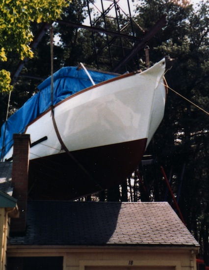

Built in the backyard and ready to head for the ocean. A 160-ton crane couldn't lift the 25 tons so it had to be moved between the houses for a better angle.
And, then the Rachel J flew over the garage.
