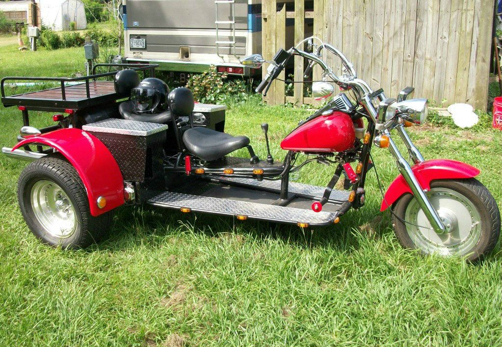

Welcome Marcie & Big man from another one of the big guy crowd over in GA! Using CPES or epoxy will seal real well and you would need to seal your outer skin below the AL but I would poly the inner skin for the woody interior you want. Nice trike by the way! Welcome again to the madness!
Cliff :thumbsup:

welcome to site Marcie and Big good luck with your build but if you can build that trike them you can shurly build a tear drop

I dont have any CAD programs (or experiance), although I did have a lot of mechanical drawing drafting courses way back when I was in high school. My building plans are still in my head right now, so I cant put my design on here. I just kind of build and go with the flow, similar to how I built the trike. Thanks for the compliment on the trike. It was junk when we got it. Cut off everything from the plate welded to the torsion tubes forward and started fresh. Seven months of working every day I wasn't working at the shipyard.
