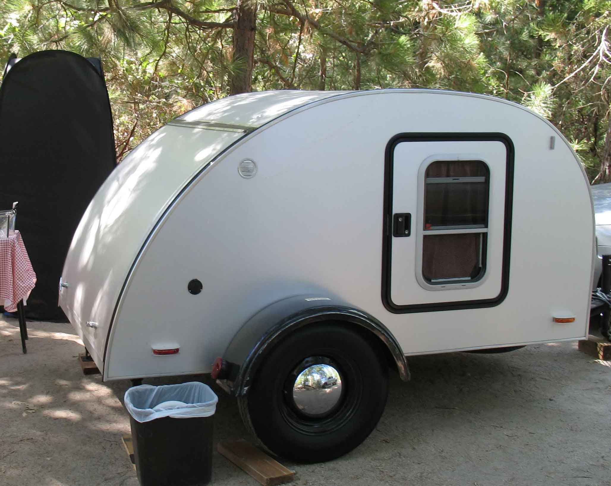

Hi, I am a new member to this group of teardrop owners. I have a silver pleasant valley 5x8 2006 drop. My husband and I are newly retired and love camping with it. Much better than sleeping on a deflating air mattress. I will need lots of advice and I haven't a clue on how the whole "battery/electrical" stuff works. Right now, the battery works when connected to car and charges when driving, but when we plug it in our garage, the power is not getting to the battery nor the electrical sockets. Any one out there have a diagram of wiring they can share? Thanks all. Beth and John

Welcome to the forum. You will find some great help and advice here. 8) Where are you in Northern California? As far as your electrical is concerned, are you referring to the 110 won't work when plugged in or the 12v? Do you have an inverter and are the fuses and circuit breakers working? :thinking:

I am in Fair Oaks in Nor Cal. Transplanted from So Cal. for work. But now retired and loving camping especially in teardrop. I don't exactly know about the electrical problem but when we plug in house current the battery is not being charged. We don't have a box with circuit breakers or fuses. Only one box that is supposed to convert house current (110?) (120?) to the 12 v battery. I called the pleasant valley folks but they weren't much help. I could use any advice you want to offer.

I would get a voltage meter and check to see if the unit is producing 12 volts, you could also get a small battery charger and hook it up to the battery. i have one i installed inside my teardrop

The duty of the converter is to take the 110 volts that you hook up to at the campsite or your home and reduce it down to 12 volts used to charge your battery and run your lights. When you are hooked up to 110 volts using a converter it will not draw the 12 volts from the battery but use the converted or reduced power to run the lights and other 12 volt systems. You only use the battery power when you don't have the capability to hook up to 110.
If you don't have a converter built into your teardrop then the only way you are going to be able to charge your battery is by either using a battery charger (which is a converter) you can pick up at any automotive supply shop or RV center or by hooking it up to your tow vehicle and charge it when you are traveling. It is important to either use an isolator, (an electronic switch that will not allow you to drain from your tow vehicle battery if it's hooked up) or disconnect it from your tow vehicle when camping and using the 12 volts.
If you have a 110 volt plug in (which it looks like you do from the photos) and it doesn't go to a converter, (changing the 110 volts to 12 volts) then you must have a 110 volt outlet somewhere in your vehicle that will be hot only when you are plugged in to 110 volts. This will be true whether you have a converter or not. Regardless, you should have a least a circuit breaker somewhere between where you plug your rig into the 110 volt current and where you can plug in a 110 volt appliance. If you do not have a converter then the 110 volt circuit is isolated from the 12 volt circuit which is usually used for running the lights, your fan or charging your cell phone through a outlet that looks like the cigarette lighter in your car.
