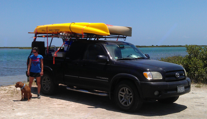

PS I am driving a 2003 Tundra with v8, towing package, truck rack with boats if it helps with your evaluation.

The kayaks are very aerodynamic, I doubt they are a significant drag, a trailer can be. Does it outweigh the benefit of room, and how much of a difference will it be?

I will Stand! I want to thanks everyone for sharing your thoughts and advice. I measured to the kayaks loaded on the truck, it is 7’10”. Seems like plenty of room to build a standy with-in that profile, but dang those little shorties look so cool! I have literally made 50-75 different profile and floorplan drawings to figure out what I want, what I need, and toned it down to what is realistic. I am going to keep lurking and learning, but you guys have helped me get out of a rut of indecision and establish basic goals.
