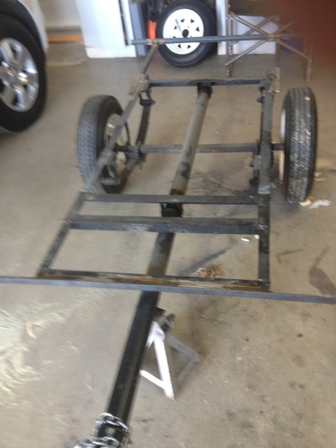

Well it's basically complete minus, door and fiberglass, its about 325 right now so the total weight should be about 400 loaded. I do wonder about wind but I can tell you I had a pod on the frame before and never knew it was around even when loaded to close to 400 for a trip with camping gear and such. So braking and towing I'm ok, but I am wondering on wind. I do want to add roof mount fishing rod holder but 2 rods should be very little more weight. Oh and that 325 is with the mattress in it. Went with 4 " memory foam! The frame was a commercial pod trailer frame from the early 80's I salvaged the tongue and axle and used 1 inch angle iron to rebuild the framework and the tongue will rotate 360 degrees so no locking up when I go in corners. when in the pod configuration I was dragging foot-pegs on PCH and never knew the trailer was there. Mike

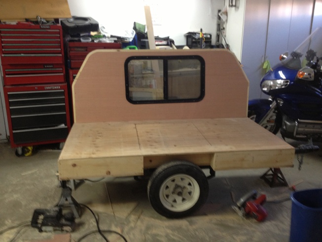

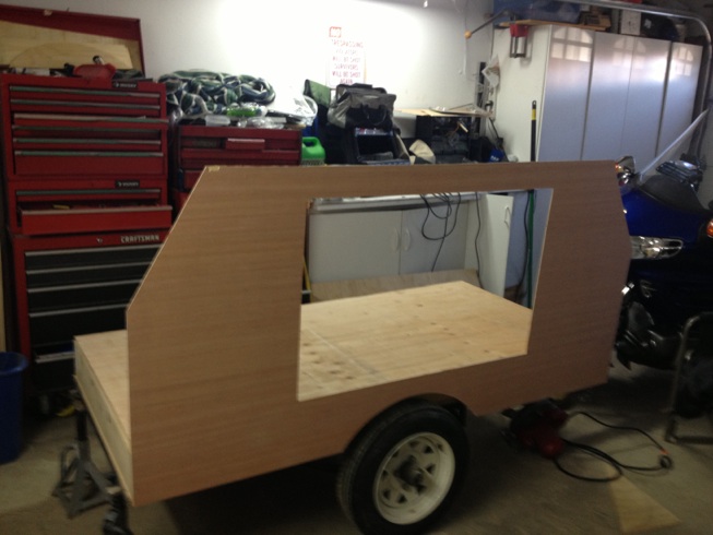

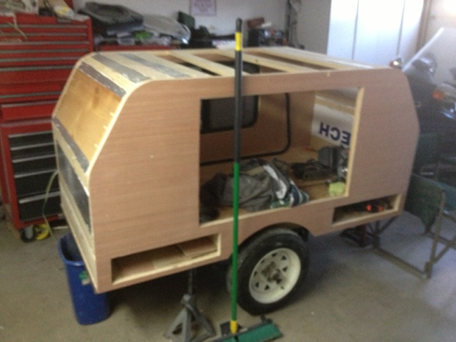

Postby gl1800mike » Thu Mar 28, 2013 1:59 am
well they are just barely over 1" thick, I used a 3 layer plywood panel as an inside and outside skin over 1x4 frame with voids filled with styrofoam insulation. I
sidewall built and ready for install
frame with a side wall plywood panel and base storage above the frame
the extended frame

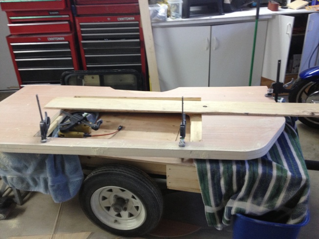

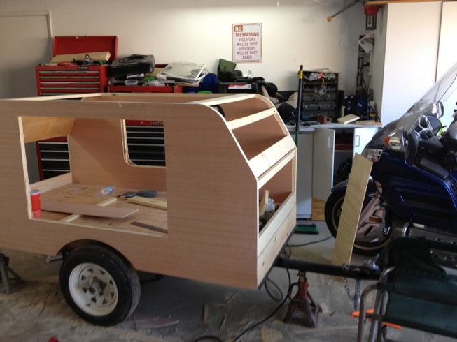

Re: Motorcycle Teardrops
Postby gl1800mike » Thu Mar 28, 2013 2:03 am
more pics of construction
As you can see there are 3 storage areas, a center on with the spare and a gel cell battery inside these are accessed from under the bed since they won't need constant access, the front and back compartments will be seen in some other pics about to be shown, they are accessed through small doors from the outside.
this is a sidewall so you can see it's basic construction with inside panel about to be installed
both sides and supports in place
sidewall installed with window temp installed

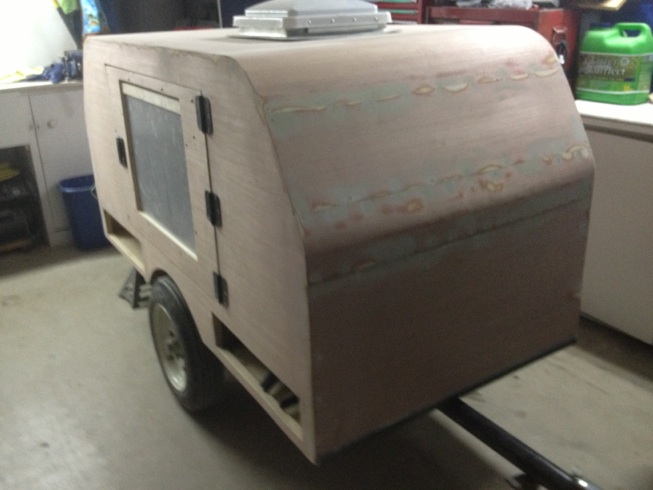

Postby gl1800mike » Thu Mar 28, 2013 2:10 am

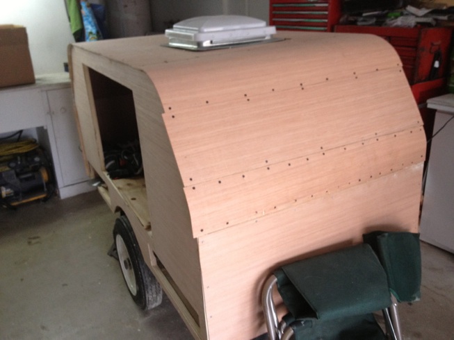

more pics
door is now built and temp installed
sheathing in place, roof vent in place still need to trim back excess on sheathing
starting to take shape, here I have the doors for the storage areas cut out

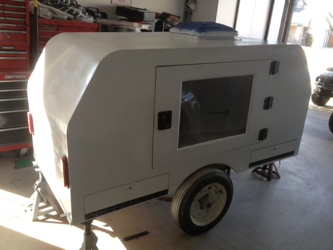

Postby gl1800mike » Thu Mar 28, 2013 2:21 am

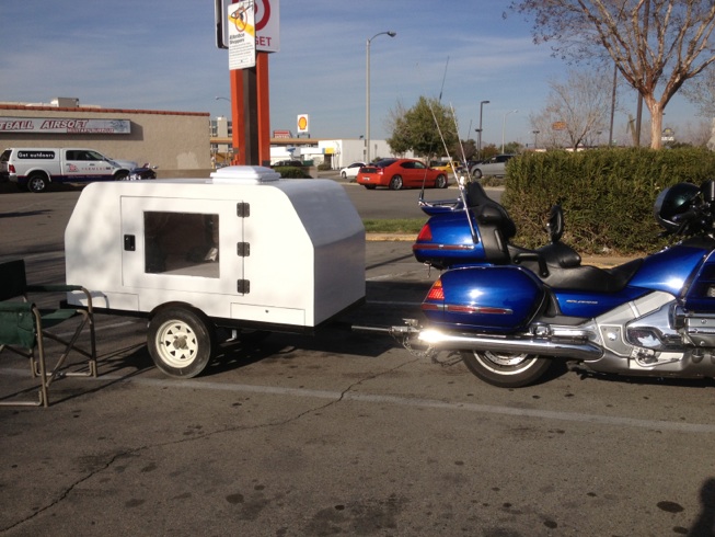

last of the pics
Fiberglass is done, and everything reinstalled this is before the first test.
Then I pulled it that night to the local bike night. second pic
I have one problem I am still working on. I didn't bias the weight enough to the front and I have a weeble wobble at about 50 mph. But today I added a cooler to the tongue and that weight pushed the mph up to 65, I'm going to add an addition steel plate under the front and I believe that will be my final fix. If I find it is fixed I will pull it 1100 miles north in May. if not I'll try and keep you advised. I'm already planning to rebuild but I have the trip in May so not until after. if it comes to it I can always go back to the pod and tent for this trip and begin the rebuild as soon as I get back. I learned alot I only have about $650 in the completed trailer and I can salvage a lot so the rebuild will be a lot cheaper. Even if I have good luck on the trip I plan to rebuild when I return to make the bias correct and I now know I way overbuilt the thing so I will lighten it probably more than 100 lbs with the second one.
Mike
all ready to tow but still in garage
bike night, first test tow
