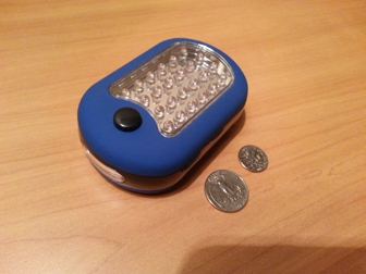

Postby suzart24 » Sun Jul 14, 2013 8:04 pm
I jus bought two of these to try out for awhile, before doing my electrical system in the TD.
I'm carpeting my walls and would like to use them as interior lights. I can put a tab of Velcro on the back and stick them anywhere I want.
They're even bright enough to act as outside lights.
Harbor Freight...AAA powered for $3.50 each.
