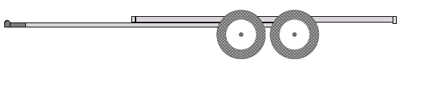

Postby AZLugz » Thu Apr 24, 2014 9:51 am
This is kinda what I am thinking on the trailer. extended frame and tongue and the tandem axles.
On the original frame, i think it will mean moving the axle back, then adding a large piece of the second frame to the back and putting the second axle toward the front of that. The rear axle front spring mount will be right behind the front springs rear slipper mount. May come up with a double mount for the middle also.
