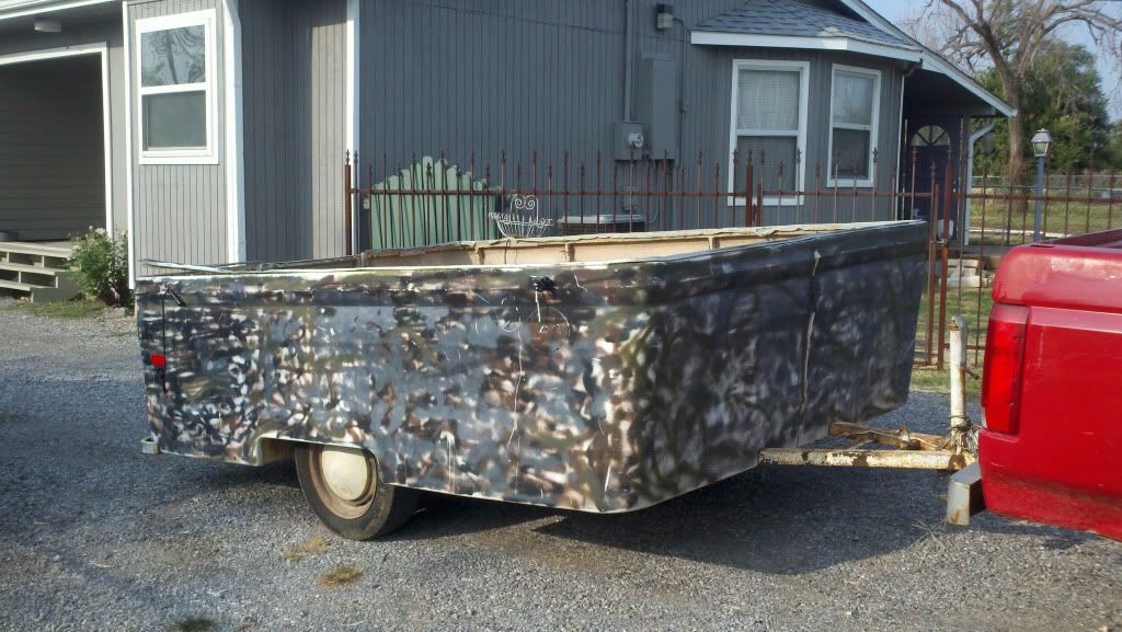

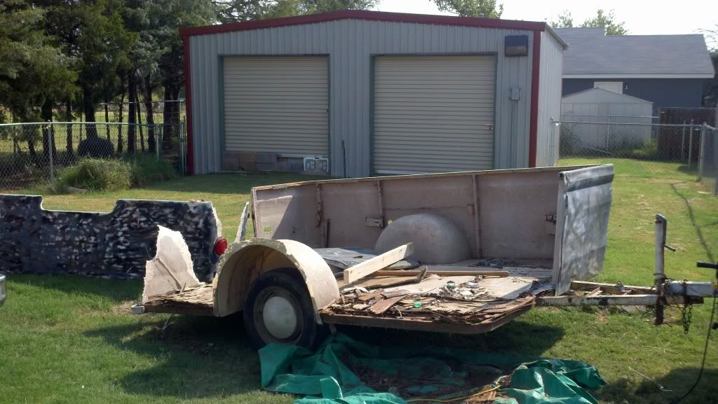

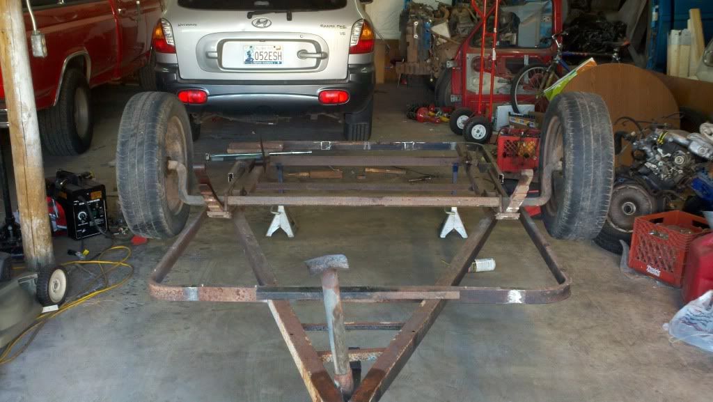

To that end, last weekend I had to drive up to OKC to give my friend a fridge for his and his lady's new house, I also had some spare $$$ from selling parts of one of the trucks. Seemed like a great exuse to pick up an old pop up trailer frame since I had to drive a truck anyway. I drug home a likely late 60's vintage Camp Craft Capri that had been stripped for use as a trash/scrap trailer... grand total of $100. Since then I have stripped it down to the frame, made sure I could find replacement wheel bearings (although I destroyed one of the dust caps not realizing they SCREW INTO the hub... weird, but a Ford truck dust cap is an easy friction fit), and I unbolted the shackles to see how much drop I could get. The trailer currently measures 4' wide on the frame rails, 6.5' wide total and a 106" long + the tongue. My intent is to narrow it down to about 4.5' (just inside the tires) and bob the end to 8' to get the proportions right. I'm also going to need to rebuild the tongue. Did I mention I've never welded in my life until last night?!?!

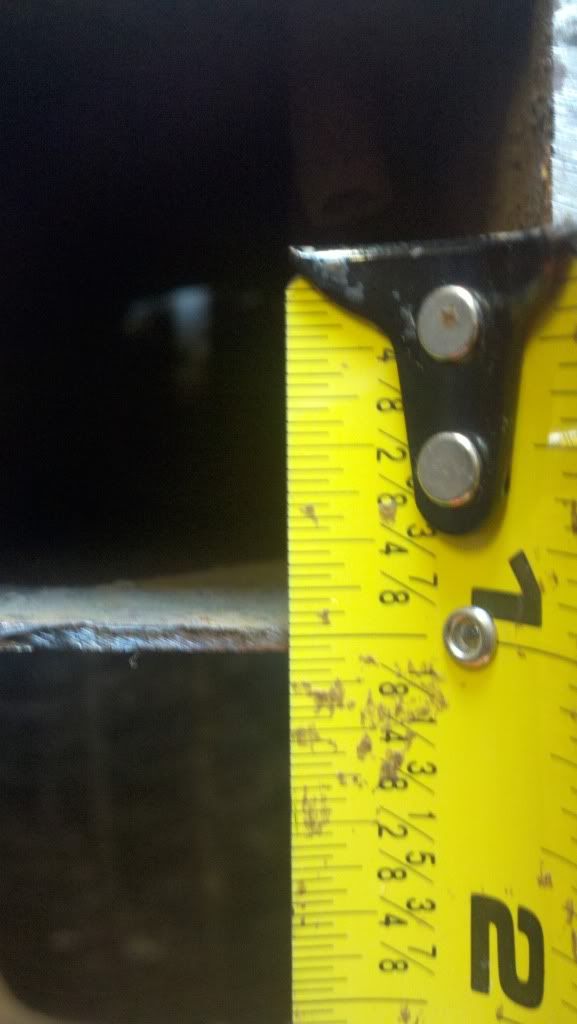

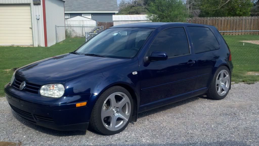

My goal is to built it light and low to go behind my GTI. It has a rated capacity of 1300 kg (2800ish lbs) with brakes and 600kg without brakes. The car is lowered so I want the trailer to be similar and I'd like to keep the overall height of the TD to about 54" so it's near even with the GTI's roof. With the shackle drop, I measured about 9" under the frame rail, so with 4' sides, it should work out well. I'm still beating design ideas around in my head as far as how extensive it will be, I do know it WILL have a/c and electricity (likely 12V and 110). I'm thinking laminated walls (1/4" outer skin, 3/4" framing, 1/4" inner skin) and I'd like to make Scotty-Style siding for it with a metal brake. This will be a long term project especially with my Beetle coming back online, but it's something I've wanted to do for a very long time and I'm really excited. I need to start building sketchup models and making drawings soon... I need to get the ideas in my head onto paper.

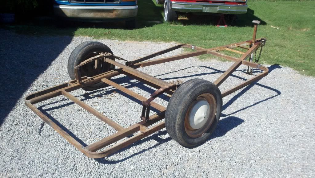

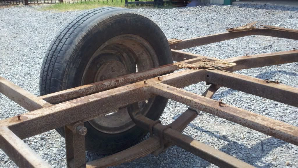

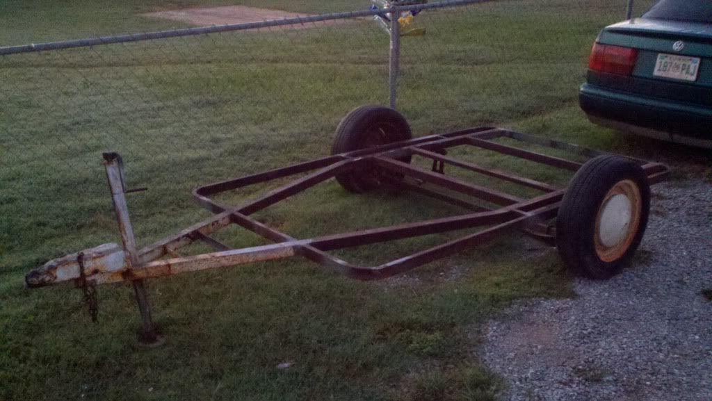

Anyway, pics.

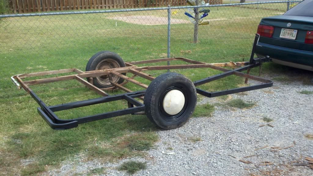

Ugly as sin, but $100 with a solid drop axle and 15" wheels
Tow Vehicle :D She's 8 years old and the newest car I've ever owned... it gets babied. I'm going to be ordering a Class I (2000/200) receiver for it within the next few weeks as I need to flat tow my Beetle to Tulsa to finish the motor build.

That looks like a great start for your project, I'm looking forward to watching your build.

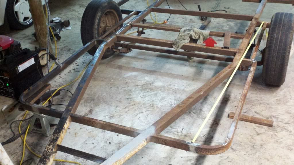

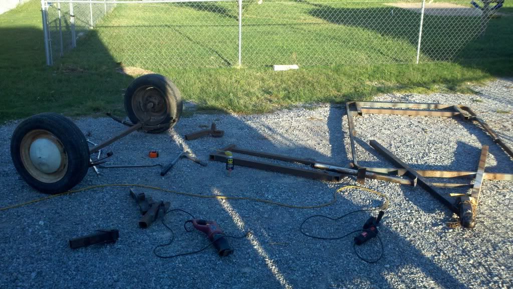

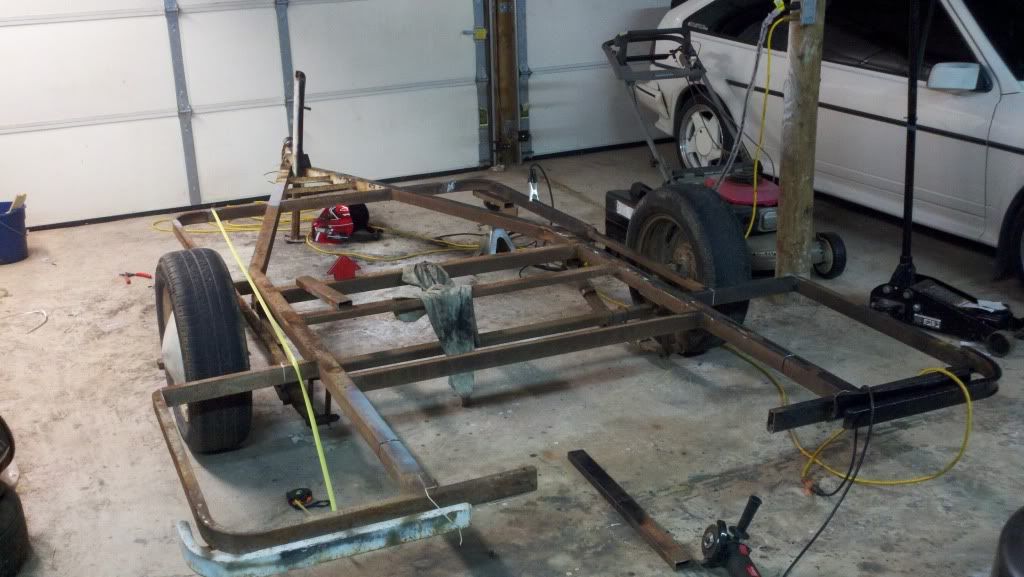

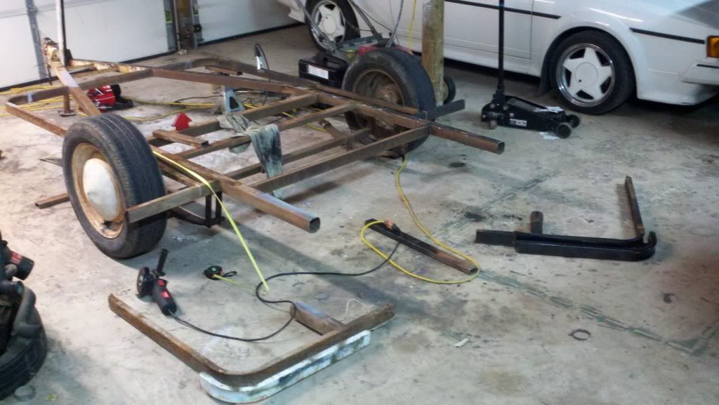

Last night I cut off all the rusted in screws, welded up a split in the tailing edge of the frame rail and started laying out the cut lines. Amazingly the axle is 57" from the front edge of the trailer, so I can bob the back 10" off to get a 8' trailer and have near perfect proportions as far as axle placement. I've been toying with designs, I really want it to be LOW... to the point I considered making the frame deeper by using 1" square tube to build 4" lower sides that the wood side panels would attach to and make a really neat looking swept under side profile, but unless I did a drop floor or was trying to hide other things like tanks, it's really unneccesary extra weight. Btw, if I did do that I'd have about 4" of clearance... yes I'd need to weld casters to the back edge of the trailer. Bear in mind I can't clear a Fosters can on it's side in my GTI... it's a sickness But I do want to be able to get the camper into camp sites even if I have to position it by hand... so practicality will probably win that battle, lol. I'm going to check on getting some 2x3 tube this weekend to start re-engineering the tongue too.

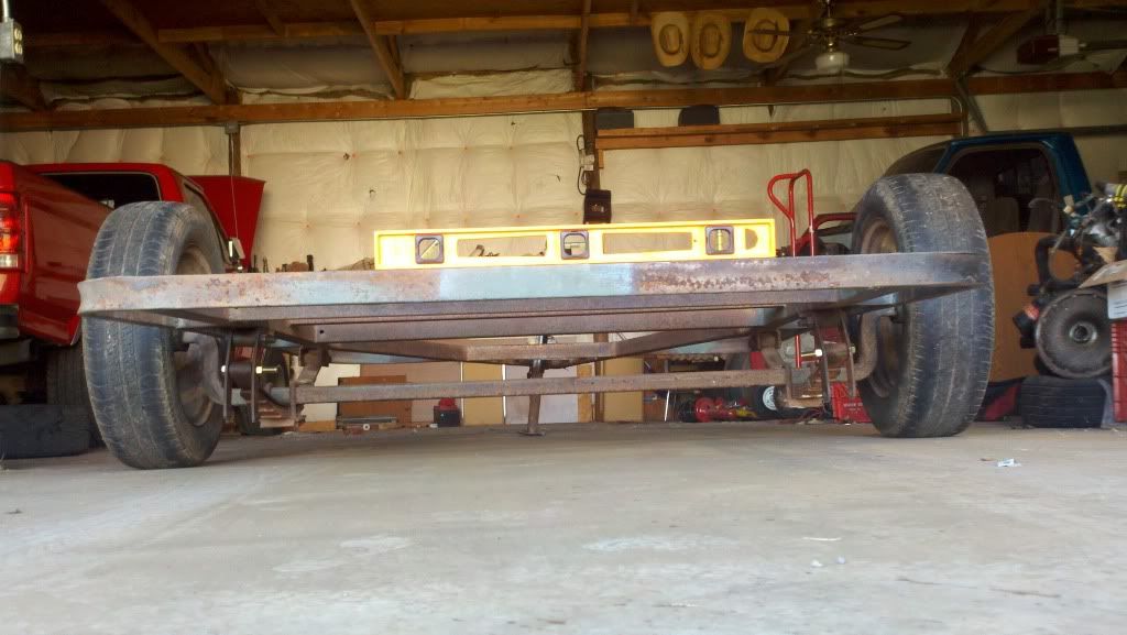

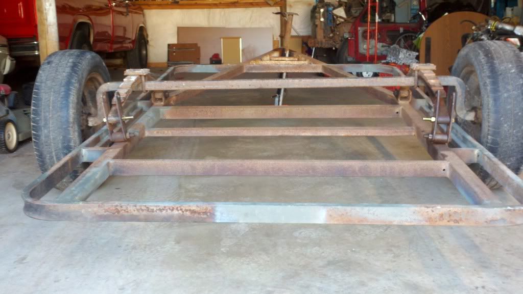

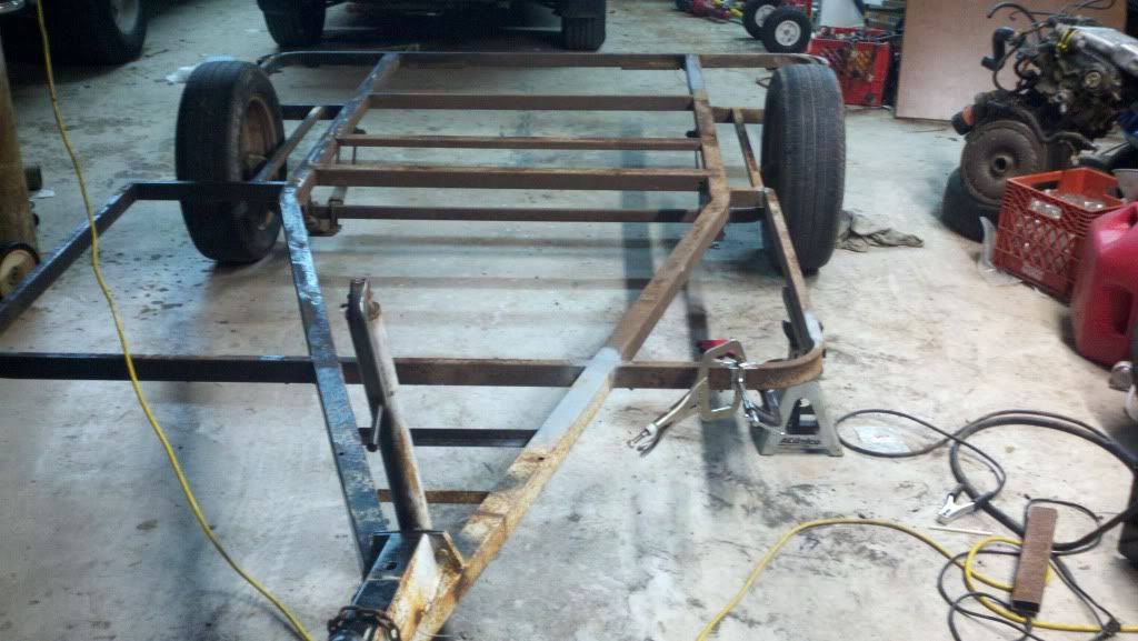

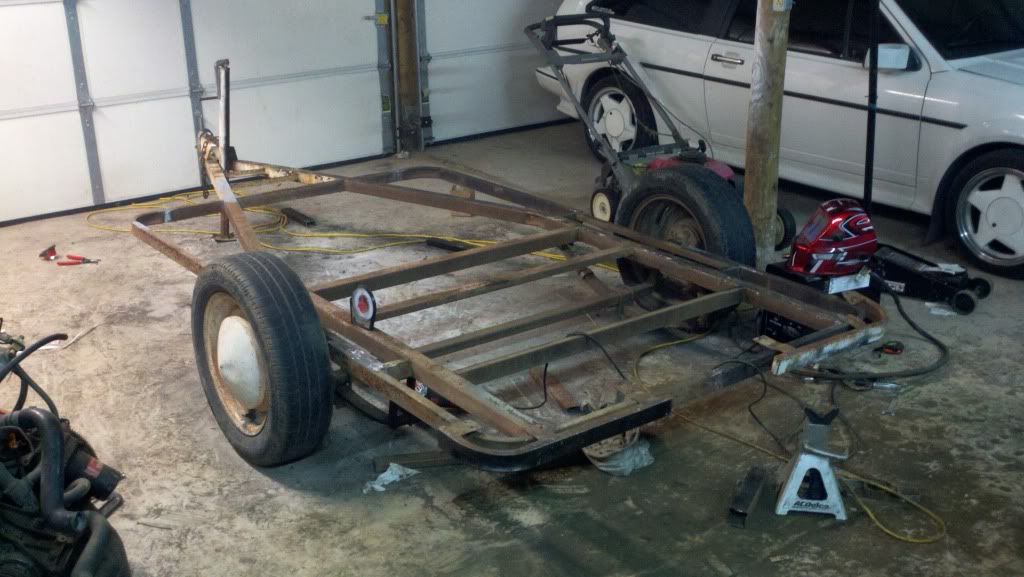

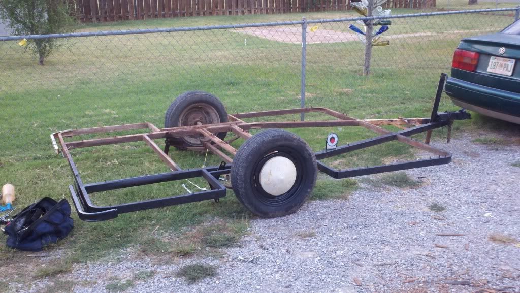

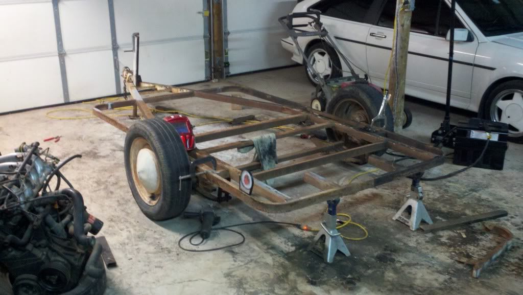

The result of this weekend's shenanigans... bobbed 10", narrowed 25.5"; result 57.5" x 8' with the axle about 38" from the tail. I need to notch the sides where the drop axle comes up as the clearance is VERY small there, that will require making a small frame for the trailer sidewall to go over it too, no big deal. I started on drilling the shackles to lower it, but ran out of time thanks to fighting with a cheapo cordless drill pushing a 1/2" bit (my 50 year old corded only has a 3/8" chuck). I need to acquire new 9/16" spring bolts and bushing to finish that up right and then some new square tube to rebuild the tongue. I'm going to wait to mount the coupler until I have the receiver on the car so I can get the height perfect.
Any tips on which website has the best deals on trailer hardware? Shackle bolts, bushings, bearings, u-bolts.
Guess I should start a build thread...

Postby Vedette » Mon Sep 23, 2013 9:19 am
Welcome to the Forum
Thanks for the great pictures! :applause:
You look like you are doing just fine!
|I too would have suggested better wire for your welder (flux core is not great, nor fun??)
As I weld every day, I always recommend to friends buying a welder that they get the "best one they can" as you normally only have to buy one that you will probably have for the rest of your life. And use argon/Co2 mix gas!
Migs make heroes out of all of us!
But that being said, you look like you have a handle on your build and you are going to have a great time with it.
I know I did! The trick is.....stay with it. Even when it starts taking longer than you think it was going to.
The Bug may get pushed back (my Studebaker did) because this does become an addiction! :twisted:

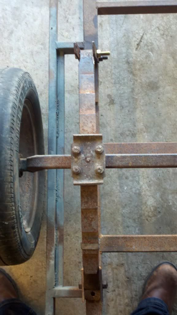

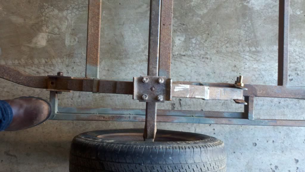

So this confused me. The springs on this trailer were set at an angle. If looked at from above and behind the axle, they looked like this /-\. Strangely though the front hangars were welded at that same angle... but the rear shackles weren't vertically aligned. According to a guy I talked to today, it was common into the 70's for small trailers to be built that way to correct for the crown of the road... beats me. See the pics. After realizing a few things... I took the sawzall to the frame: one it's been abused to death, two the frame is made of crazy thin tubing, three a single 20' joint of 2x2x1/8 to fix the tongue would run me $40 and with one more stick I could build an entire new frame, four after welding up three frame rail cracks one had started to re-open from frame fatigue... so it's gone to scrap pile heaven. This weekend I have to prep my Scirocco to ship it to GA, but I'll get back into this soon. I'm going to re-use the axle/hub/wheel/spring assembly and the nice old Atwood trailer jack. I just need to re-bush the spring eyes.
