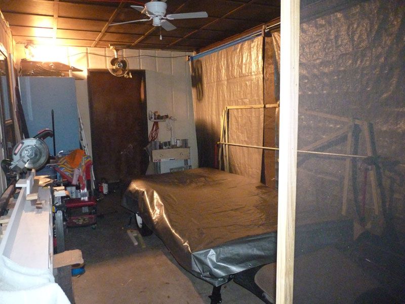

The project is being built under less than ideal conditions: on a carport in a sub-tropical climate during rainy season using pretty much hobbyist grade tools by one person with very limited woodworking experience. The build starts with some highly-modified Harbor Freight cheapness, adds some nice strong wood and Kreg pockethole joinery, salvaged RV windows, and should finish with more of an "Ikea utilitarian instead of fine cabinetmaker" design.
I've got some pictures documenting the progress but nothing like some builds (but I do have some blue tape). 2plus inches of rain a day, a few days in a row, gives me the time to finally make this first post. With having raw unfinished wood in place I've got a regular batten-down-the-hatches routine now. That sometimes happens several times a day during build-time.
Here is where I'm at right now:

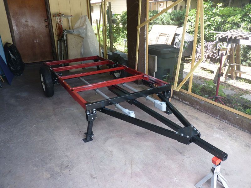

I don't really do simple well. I've got a background in architecture/engineering/project mgmt and keeping it *not* simple is kind of how it is. Besides, I've already got the HF trailer modified with relocated axle position, underslung axle to lower it, gas shock absorbers, relocated/replaced the center cross-members to the outside rails as stiffeners, added a center tube and angles to the tongue for stiffening and extending, four corner stabilizers, and two electrical conduits from a tongue box one for the trailer brake/turn/marker lights and the other for electrical to an underfloor electrical closet.
I currently camp without a trailer and slapping one together quick isn't necessary for me to go camping. I will likely build just one unless someone else wants help with one later or something catastrophic happens to this one.
You might not want to hear all about the part where I loaded the frame in one foot cross-sections down its length with approximate weights in order to get a realistic amount of settle in the suspension in order to space the new shock mount holes an appropriate distance apart for the amount of travel in the shocks.
Here is the trailer frame mostly completed after a few fairly simple modifications. It now has some wood attached. I'll start a thread in the build journal place with photos and try and catch up to where I'm at now with it.
