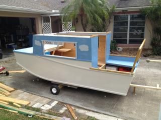

Here is the 11ft long shanty boat I built - no plans for this, but I can tell you how I did it, if anyone is interersted. It weights about 270lbs and motors nicely with a 4hp outboard. Theoretically, I can camp out overnight on the banks, if I could keep out the mosquitos and it doesn't rain.

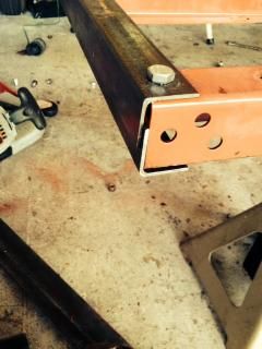

I am finishing up on my 30" front stretch of a $50 used 40x48 HF mini trailer- it's a custom build for my shanty boat. That bed frame steel is really hard to drill- I finally broke down and bought a small stick welder. I relocated the tongue 12" further forward and added angle iron for an A frame front- it's very solid.
This trailer is only for local use. I originally bought a 5x10ft lawn service type trailer for my flat bottom boat- it weighted 800lbs. I quickly realized this wasn't ideal at the ramp- way too heavy for a 300lb plywood boat . So I sold it --- this boat trailer will be closer to 200lbs when I get done.
The angle steel overlap provides a lot of strength after welds are added on the sides and cross members.
