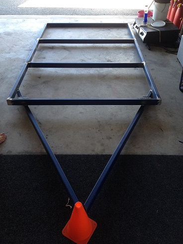

so far we have the trailer frame cut and welded and now just working on axil position

Hi Mike, welcome to the board. I'm a simple woodworker, with 5 wooden teardrops built so far, all on Mickey Mouse Harbor Freight trailer frames, with no problems. It looks like you have a great start, with the welded frame, which I assume is channel iron. I'm not any kind of an engineer, but it looks like your tongue is about 9 times longer than the short attachment point at the front corners of the trailer frame. I don't know, I may be wrong, but if your tongue weight is about 200 lbs, this torque or moment of strain could put a serious 1800 pound flex condition on the corner welds. I'm not knocking your design, but just suggesting you take a closer look at this potential weak point, if it is one. Again, I know nothing about welding or what it takes to make a weld fail, so I am hoping that someone more familiar with the length of overlap required for a really strong connection. Come on, engineers.....chime in.

Roly Nelson wrote:Hi Mike, welcome to the board. I'm a simple woodworker, with 5 wooden teardrops built so far, all on Mickey Mouse Harbor Freight trailer frames, with no problems. It looks like you have a great start, with the welded frame, which I assume is channel iron. I'm not any kind of an engineer, but it looks like your tongue is about 9 times longer than the short attachment point at the front corners of the trailer frame. I don't know, I may be wrong, but if your tongue weight is about 200 lbs, this torque or moment of strain could put a serious 1800 pound flex condition on the corner welds. I'm not knocking your design, but just suggesting you take a closer look at this potential weak point, if it is one. Again, I know nothing about welding or what it takes to make a weld fail, so I am hoping that someone more familiar with the length of overlap required for a really strong connection. Come on, engineers.....chime in.
Good luck on your build, Mike and please don't think I am critical, but just asking. I'm looking forward to seeing pics of your one-of-a-kind teardrop trailer, my favorite style of TDs. I know you will enjoy your camping trips all around North and South Island.
8) :thinking: :thumbsup: Roly, the li'l ol' woody teardrop guy in So Calif.
Thanks for the feedback. Better to know now. I might chat to a engineer as i can put a beam down through the centre. Want to get all this sorted before i hot dip galv it. the frame is 65*35*2.5 box section :)

If you look at how I did my drawbar you might be able to add a center member and end it how I have.
My a frames alot longer but I'm thinking more attachment points on the center member might save you having to undo work.
One other thing it's frowned upon by the authorities to weld across the draw bar...not sure if you have but australia and nz prefer you weld the sides of the drawbar to the cross members and frame rails rather than across.
