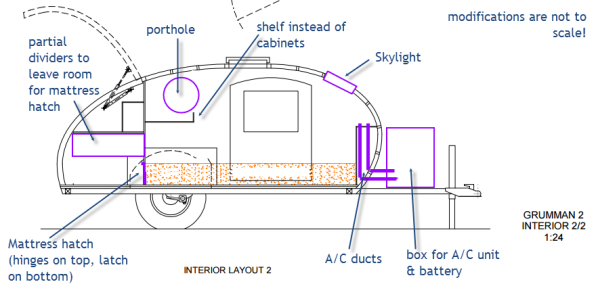

Postby plectrudis » Wed Mar 18, 2015 9:01 pm
Here's a very rough not-to-scale image of what I'm thinking about:

Postby pchast » Wed Mar 18, 2015 10:11 pm
Welcome! :D
It seems that your extra windows and skylite should add a bunch of heat in
your locality. The AC on the tongue will increase your tongue weight a bunch
You should get the balance spreadsheet and check the effect of that weight.
:thinking:
Check http://www.t.tnttt.com/viewtopic.php?f=35&t=59449

Postby tony.latham » Wed Mar 18, 2015 11:56 pm
We want to use a real mattress, not a foam mattress. I'm thinking of making a latchable door in the bottom of the bulkhead between the galley and the cabin to allow us to install/remove a real mattress. Is this a bad idea?
When my wife and I were almost home from Zion a couple of years ago, she turned to me and said, "It's not that big of deal to come home anymore."
"Sweeet Jesus," I said to myself, "Have we got some relationship issues?"
Now this was on our first big trip with our newly completed 5x10 and many years behind us with the 4x10.
So I glanced at her and said, "What are you talking about?"
"Our teardrop mattress is as good as our bed."
Whew. Double whew.
In fact, on the way home we needed a shower and got a motel room in Tremonton. The bed was horrible. We both agreed we shoulda staye in the 'drop.
We have a 5" foam mattress with a 2" memory foam topper in our 'drop and it's sweat. Hard to beat. Scratch that: Can't be beat.
Bad idea? I wouldn't throw it in that pile. Our teardrop –for material reasons is 60" on the outside and the walls are 1.25" thick. (There's a real good reason that it's built 60" wide and not 60" inside.) Thus the interior isn't quite the size of a queen mattress. But a good queen sized foam mattress fits just fine. Even with an access door, I don't think you could slide a 60" wide mattress into a 57.5" interior. If you're bulidng with 3/4" walls, I still think you want it 60" on the outside, not the inside. Is it going to fit in a 58.5" interior?
I might have to take a nap in Flash tomorrow. Sweat, quite, and comfortable.
T
p.s. That skylight could be a challenge. A flat window on a curved surface. I'm sure it's doable thought.

Postby plectrudis » Thu Mar 19, 2015 8:35 pm
Pchast--thanks for the tip about the tongue weight! I'll be sure to look into it. If it turns out to be prohibitive, then that clarifies my options re: mini-window-unit versus ClimateRight. I am a little worried about the heat from the windows, though I was hoping tinting/curtains would mitigate it. Or perhaps I should use little mini-skylights instead.
Tony and Vedette, I'm delighted to hear that your foam mattresses are so comfortable. My husband has a bad back, so I assumed we would need a real mattress; but after your testimonials, I think we should reconsider. I was planning to attach the walls to the outside of the floor (one of the build logs I've looked at did this), though I do have some reservations about the stability of that approach. So if the foam mattress gets a thumbs up from my husband, we can take the more conventional approach, which will probably be easier and stronger.
