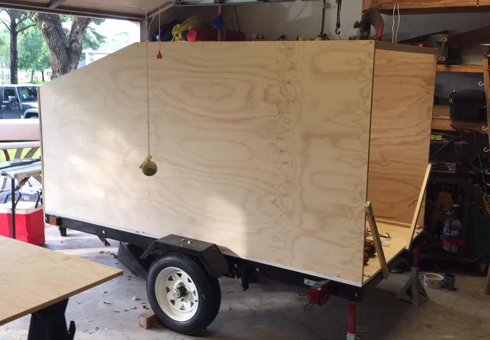

Postby duncanmcginnis » Mon May 25, 2015 7:40 pm
I'm a new poster, but I have been studying many tiny campers here for some time. I am about 75% done with my first build. Door and windows should arrive this week. This picture is only with walls up. It has roof and the inside ceiling has been insulated. I will put up a build log when I figure out how. 8)
walls up

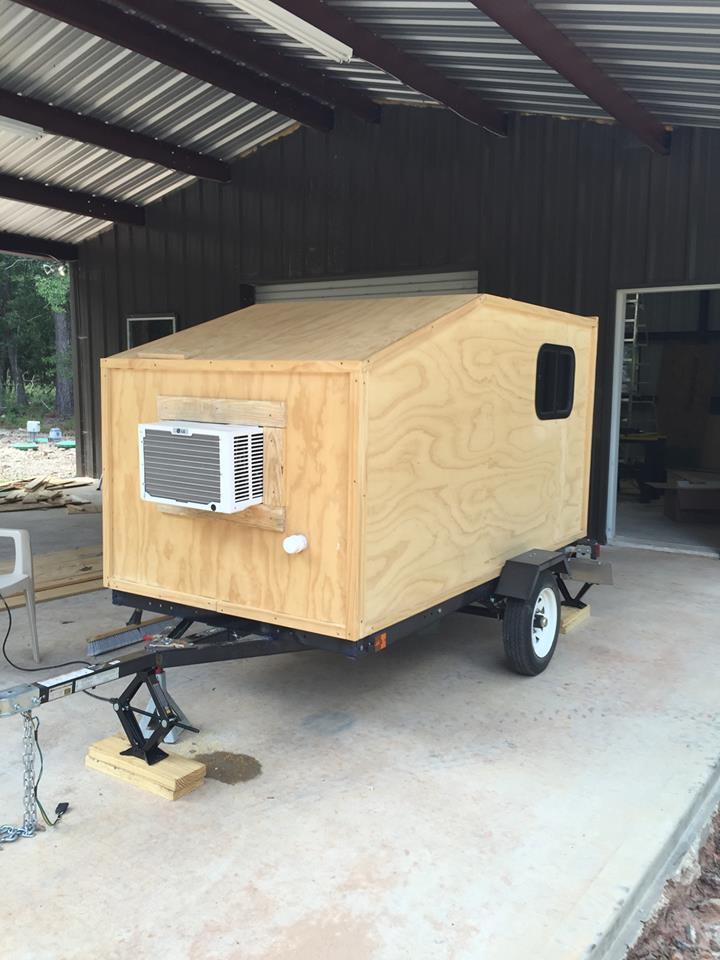

Postby duncanmcginnis » Sat Jul 18, 2015 3:47 pm
Finally closing in on completion. Installed AC today, will finish trim this week and paint soon thereafter.

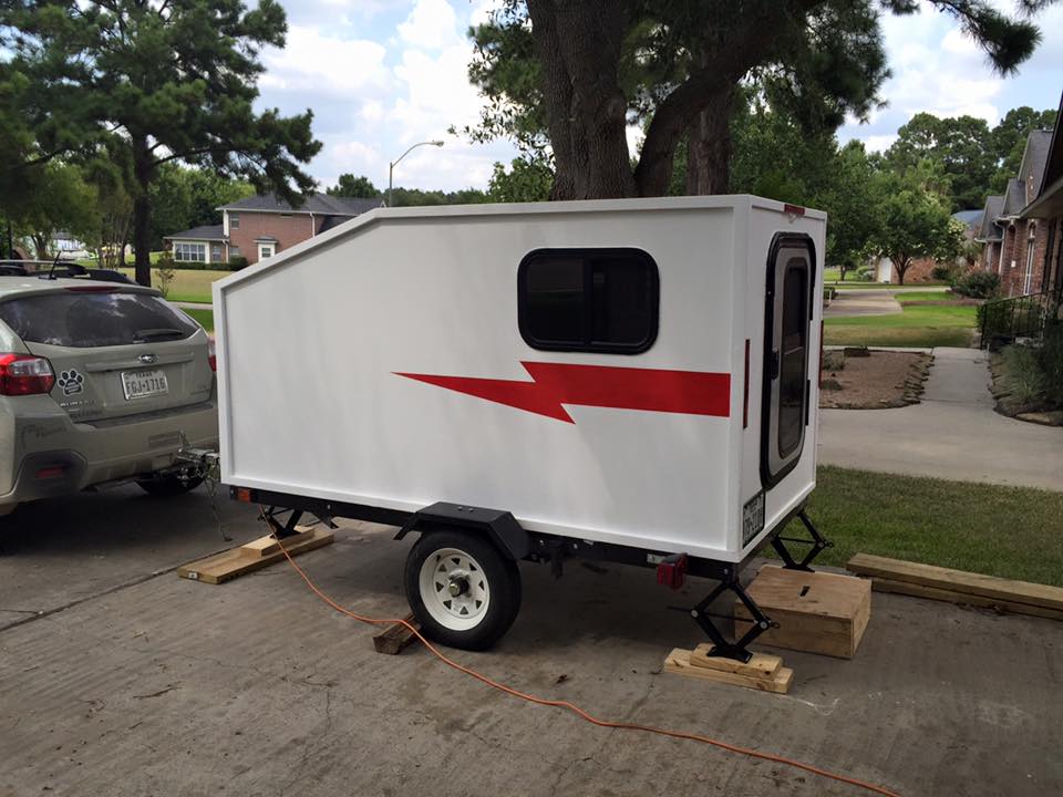

Postby duncanmcginnis » Tue Jul 28, 2015 2:08 pm
Done! (Mostly). But I see how this project will never be totally complete, at least until I sell it and start another one.
tiny trailer final.jpg (87.21 KiB) Viewed 559 times
duncanmcginnis
Posts: 5
Joined: Tue Mar 31, 2015 3:24 pm
Re: New guy 75% through first build
Postby Junkboy999 » Tue Jul 28, 2015 4:23 pm
Nice looking camper.
Is that top flat where it meats up with the front angled piece, or do you have some trim up there that might stop water? On thing you don't need is water collecting on a flat roof. Water can collect on the top of that bottom trim around the camper as well. I good bead of sealant, a slightly beloved top surface or a long piece of triangle stock glued in there might help hold off water collection.

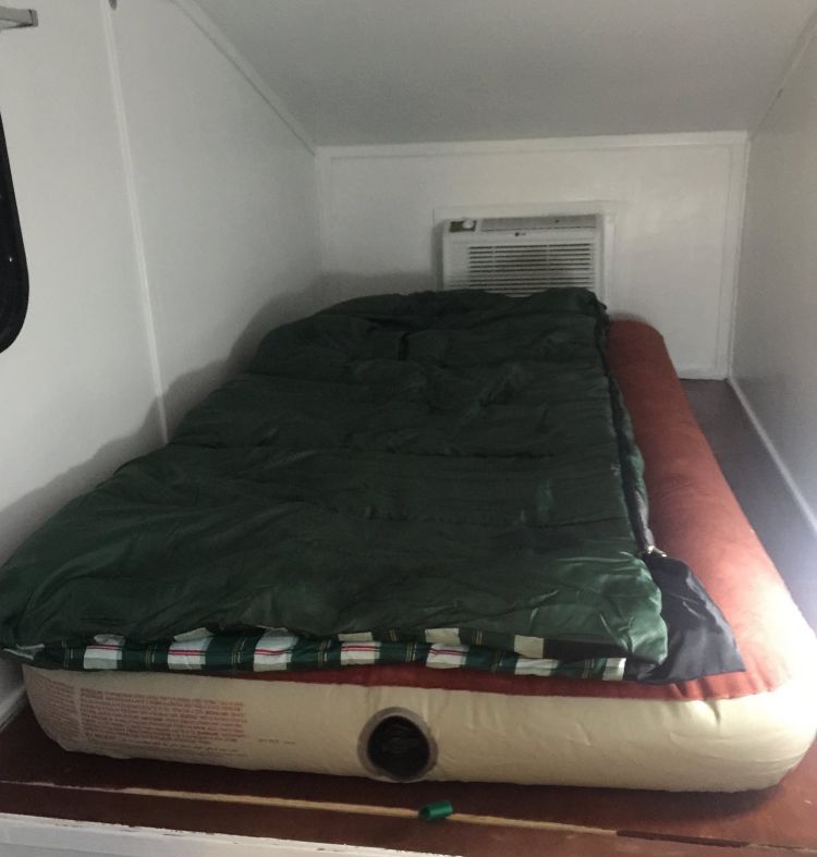

Postby duncanmcginnis » Tue Jul 28, 2015 8:54 pm
Here is the inside, should have mounted the AC higher up too. The top is curved slightly. Every joint, and seam is sealed with Bondo, two coats of primer and three coats of paint. I may paint the top with something like Plasti-Dip or spray on bed liner. Most likely I will save those design elements for the next one.
