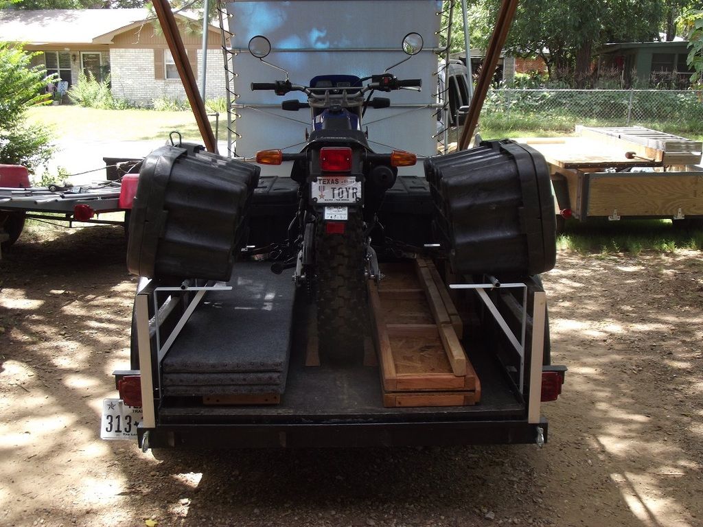

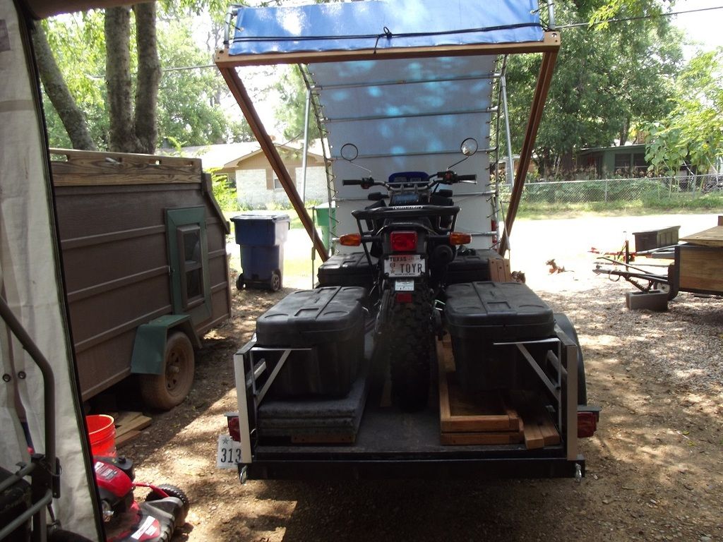

I am presently doing something very similar. I carry my Yamaha TW 200 on a 4 x 8 trailer that I had rigged with a teardrop shaped clamshell frame with a canvas bikini top:
I carry camping supplies in watertight truck boxes:
The rear boxes swing up to unload the TW and also serve as a galley:
Depending on the weather a tent/bed platform (stowed at lower left) attaches to the outside of the trailer with the TW onboard or across the side rails of the trailer with the TW unloaded.
