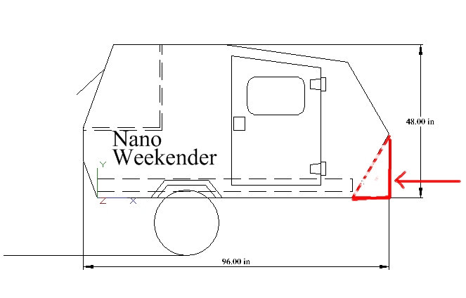

What is the purpose of the front slant where the Tongue Box goes....I was just going to carry that all the way down for ease..and more room perhaps.

I was referring to the front bottom,, if I can get a logical answer for the cut back design, then, I'll build it that way
otherwise, continue straight down would be the way to go.
I t's the front cutback area I refer to
If there is a logical reason for it, then I shall build it that way. ';)

I'd say probably aero dynamics and asthetics but I'd be inclined to do as you plan, gain a decent amount more room for no extra work

I do like it as a design element....but it's not absolutely necessary, true.
good point about aerodynamics....
Franco

If you added a tounge box I recon it would look better with the straight front

Postby azgreg » Mon Jul 06, 2015 7:53 am
dales133 wrote:If you added a tounge box I recon it would look better with the straight front
That's what I was thinking.
I was just looking at Mike's thread on the Nano the other day and hoping someone would make one. This should be fun.

Postby mikeschn » Mon Jul 06, 2015 8:06 am
I angled that front edge down to be able to use the HF 4x8 trailer. If you go vertical instead of an angle you either end up with a shorter box, or a longer trailer, which adds more weight and cost.

Postby bobhenry » Mon Jul 06, 2015 8:51 am
If I were building it I would leave the extra space in tact. It is hidden in the draft of the tow vehicle so the aerodynamic argument goes out the window.
Build the floor in a manner in which it will support a cantilever and be sure and reinforce and lengthen the HF stock tongue for strength and improved towing manners.

Postby azgreg » Mon Jul 06, 2015 9:03 am
mikeschn wrote:I angled that front edge down to be able to use the HF 4x8 trailer. If you go vertical instead of an angle you either end up with a shorter box, or a longer trailer, which adds more weight and cost.
In the post on the other thread you sais this:
mikeschn wrote:
Strangelymade wrote:Please carry on with this, the prototype looks great already, be exciting to see what you'll be using as the frame and wheels.
Nothing fancy with the frame and wheels... Just using a standard HF trailer, that has about 15" chopped off the length... For the really fancy light weight stuff, you have to see Andrew's stuff in the design library!
Wouldn't this mean that a standard HF trailer still be used and will actually still need to be shortened a tad?

Postby Franco Novo » Mon Jul 06, 2015 1:27 pm
I probably won't build a cargo box....
But it sounds like extending the tongue is recommended...
Trying to keep cost down, so I'll do the angle iron bolt on as recommended by one poster., since I haven't welded in forever, and don't trust my welding skills.

Postby jss06 » Mon Jul 06, 2015 8:42 pm
Franco, the Harbor Freight trailer should be light enough for you to turn it over by yourself. just leave the wheels/tires off until it is upright.
This is what that design looks like with an integrated tongue box.
The rest of my trailer is longer than what you are building but that is what it could look like. The box is a pain to build but it was worth the extra effort. I used this profile purely for aesthetics. The lower slope does nothing for aerodynamics.

Postby Franco Novo » Mon Jul 06, 2015 9:03 pm
Wow, that's a great looking combination you've got there John.
I do like the front cutback....maybe I'll just build a narrow tongue box because in rethinking things... I don't want to go adding on to the tongue length
Looks like you kept the back of the little weekender straight up and down. correct?..that still looks great without the little slant on the back.
Super...thanks for the feedback, and the photo . that's going into the build idea file.

Postby mikeschn » Tue Jul 07, 2015 2:25 am
ah, you're right. on the nano that angle was strictly for looks. you could go vertical, making it more like the rimple or the simple!!!

Postby jss06 » Tue Jul 07, 2015 7:59 am
Franco Novo wrote:Wow, that's a great looking combination you've got there John.
I do like the front cutback....maybe I'll just build a narrow tongue box because I don't want to go adding on to the tongue length
Best,
Franco
Yes the back is vertical. Originally I was going to do the angled back but realized it was much easier to build the hatch with it flat and it increased the storage room in the galley.
