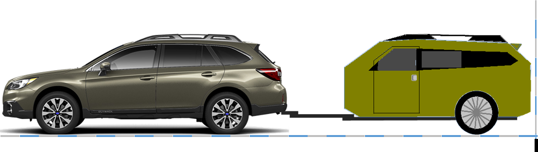

So attached (i think) are two photos, one showing the modified 5x10 foot weekender profile that is inspired by my wife's subi. That size seems the perfect blend of small enough to fit behind TV, small enough to be relatively easy/cheap to build, and large enough to comfortably fit 2.5 people. I love the profile of a traditional tear but between desiring a more squared rear (for the additional space required by the fold down) , and the ease of construction afforded by straight panels and straight cuts, this seems like a better fit. I took a lot of inspiration from the 4-day-weekender and the hopper designs. I am thinking sandwich construction with 3/4 or 1 in foam as a good balance between insulation and wall width. I also love the idea of SIP in general. Looking around it seems that many freely admit that they way over built. I'm sure I will too, especially if my dad helps out like he says he will, but it looks like SIP construction gives you an immensely strong build for the weight, IF you can get good bonds. Part of that search will be exploring non-plywood laminates, as in, what materials are as strong or lighter but strong enough, or maybe skip straight to the finished surface and skip the ply base layer. If a 3/4 inch ply with 2x4 is one end, and foamy is the other, I'm thinking I will land closer to the foamy side. I don't know, should be fun!

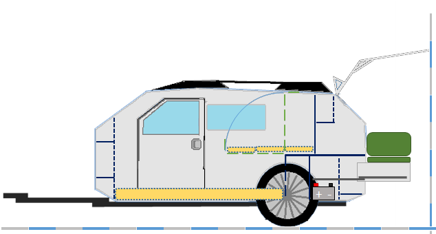

Also shown is a profile of the interior, it includes a fold down 3x5 bed for my daughter and planned baby #2. I figure once they outgrow the fold down they will be big enough for a kiddie tent leaving mom and dad on a comfy mattress. I would love to incorporate a folding main bed with a small table for those rainy days, but I'm not sure how complicated I want to me this build, or how much ground clearance I want to loose with a drop floor. I won't be rock climbing but I would like to be able to take it anywhere my subi can go, which can surprisingly, is a lot.

I was curious if you'll be incorporating the same tail light as your tow vehicle since it looks like your build will mimic the tow vehicle.
There's a teardrop out there with PT Cruiser tail lights and fenders to match the tow vehicle.

Welcome! I really like the looks of your sketch. You might review your axle location because it looks to me that it's a bit far back which would cause a tongue weight problem for your Subaru. I don't recall the rule of thumb for this.

As to your axle location comment. Yes I agree. This placement was from the trace of the Outback. I would need to move it forward at least a foot or so. Need to figure out the math on that one, but it should be simple because I don't plan on building a full rv from the get go, no heater, aircon, integrated propane, sink/running water, ext at the beginning. I am guessing that without all that stuff my galley will be relatively light, therfore I would need my axle closer to the middle. Max tongue weight is 200lbs on my Outback but I will be aiming for 120-150. I towed a utility trailer 2200 miles from Alaska down here that weighted in at about 2400 lbs total, it had 150 on the tongue and the car/trailer combo drove and tracked like a dream. I was real impressed with the subi on that trip. :-) though you could feel the weight back there when accelerating and braking. I hope to keep the weight on the TD down to 1100 or less, which should mean that I barley feel it back there.
Danny, i may try to imitate the brake lights, but cost is going to be a factor. I don't have the funds to go buy factory lights when I can spend $20 on trailer lights. I might just try to simulate the look with a C shaped running light around a central brake/turn like my car. Also not so sure how I like the cabin door looking like a car door. Just not sure if it is practical. And i still need to figure out how to work the fenders and make it either look like the subi, or at least look neutral.

Welcome. I admire your design elements of using blackout areas to simulate the window profile of the Subaru and the galley spoiler. Happy building. Bryan

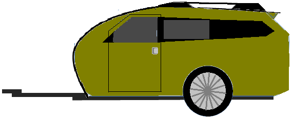

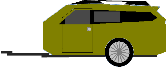

So thinking more about the curved roof vs. flat panels. I have a curved profile drawing now too. and I moved the axle up to 4 ft from the rear.
I think the wife is onboard now as well, she wants a woody w/ aluminum roof, so the green will be going.

I like to curved front better and you'll find it's a lot easier to build.
